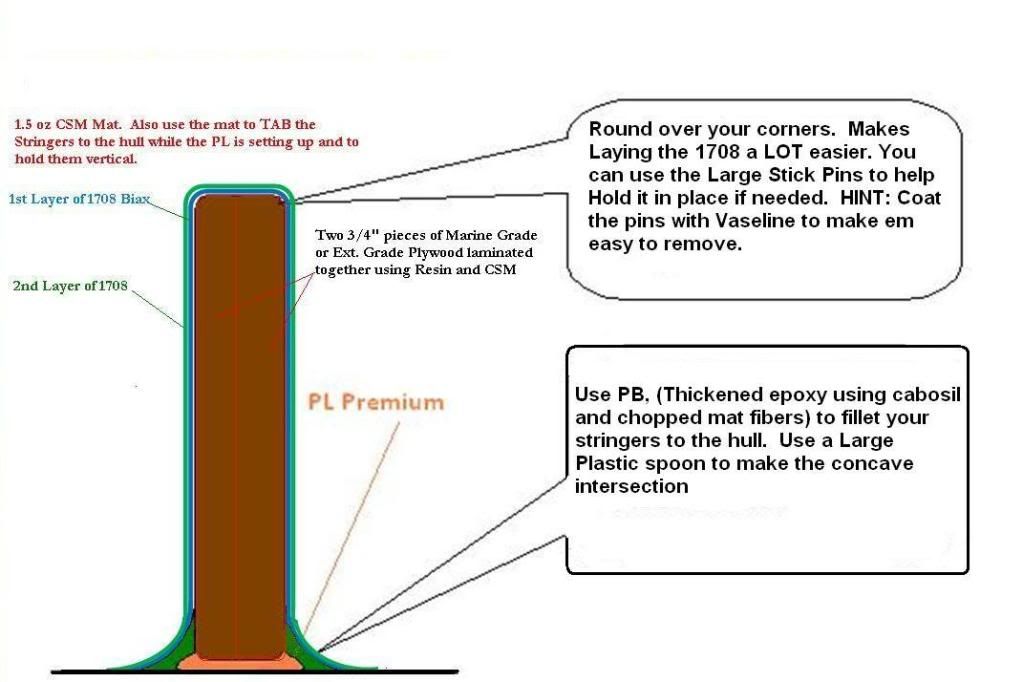

Here's how I recommend that you install your stringers. I would use the 404 or 435 Poly resin and 1.5 oz CSM mat and 1708 Biax Cloth. Start with 5 gallons of resin and 15 yds of mat and 15 yds of 1708.
Coat the stringers in Resin and apply the CSM making sure to wrap the edges. When they are dry, Lay down a bead of PL Premium Adhesive on the bottom edges and let it set for a couple of hours so it will firm up a bit. When it is firm but still a bit squishy, install the stringer and tab it to the hull using 3 inch wide by 12" long pieces of the 1.5oz mat. Mix your resin HOT so it will set FAST. This will get the stringers, IN PLACE and vertical. (NOTE: Make sure you have a way to brace them and keep them 90 degees and in place). When the tabs dry, mix up the Peanut Butter(Thickened resin) and fillet in the stringers using a Large Plastic Spoon. Wait till the NEXT DAY and then start laying the 1708 over the stringers. The first layer of 1708 should extend out on the hull approx. 4-5 inches and the 2nd 8-10 inches. Try REAL hard not to get air bubbles in the cloth. Use your hands and the stick pins to hold it all in place. A 6" Plastic putty knife works well to help smooth and spread. Just don't STARVE the cloth of resin.
(click to enlarge)
Wood,
Something in this picture I don't get. Blue and green lines that represent the outer layer of 1708 show up at the bottom of the stringer. Is this by design or just a mistake in the drawing? If it is by design, there is no way - of course - for them to be the outer layers; does this neams that the bottom edge of the stringer was glassed first before beding the edge on the PL?!!

Good CATCH!! Mistake in Drawing!!!! The Stringers Are ONLY encased in CSM Before Bedding in PL. The 1708 Is ONLY on the OUTside and Attached to the HULL. I will correct the drawing for future Posts. Thanks for the Heads Up!!!

Here is the corrected Drawing...

When you set your stringers....
Use some 1/4" dowels as spacers to hold the stingers up off the hull. don't worry about irregularities the PL will fill em. Make sure you have a bracing method devised to hold everything vertical. Squirt the PL under the Stringers and use a Large Plastic Spoon to Fillet it all in place. HINT: Dip the spoon in Paint Thinner to keep the PL From sticking. NOTE: The PL MUST cure for a minimum of 36 - 48 hours before you can start glassin'.
Once it cures, remove the spacers and cut some 3" by 10" strips of CSM and tab in the Stringers to hold em Vertical and when the tabs dry you can remove the bracing.

Like my drawing shows, you're gunna be mixing some thickened resin when you set your stringers so use it to fill the gouges then. Sounds like your making progress. Uhhmmmmm where's those pics to prove it!!!!:eek:
