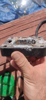

I don't think there is enough permatex #3 to overcome dunking the motor mounts in saltwater.. The fact that the inner sleeve was tight enough on the bolt to yank the rubber mount out of the flywheel cover tough to plan for....
I'll have to check my hardin O2 plate as well. I'm in fresh water but you have a chit load of corrosion on it for something that was anodized. I think I can put a bore scope in the sensor hole and see if it looks chewed up. Hate to take it off as it took half an hour to chip off the old gasket..

Getting close. Put the motor in without the spacer. The alignment is the same as it's always been (not perfect, but I think acceptable). Was able to fire it up on muffs.
1. That O2 spacer was toast. I'd love to have it in there, but that was leaking. Plugs had (I think) some salt deposits on them. I'm going to email Hardin and see what they think.
2. The elbows were suspect. Interestingly, the side with the spacer was the one in better shape. I'll need to keep an eye on them, probably replace next season. Manifolds still look great.
