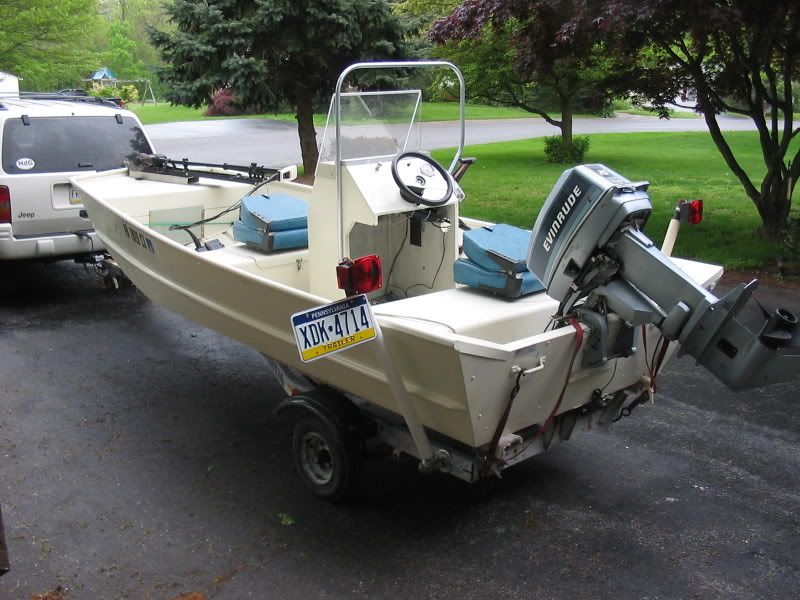

I understand the lights on my boat trailer need to be submersible so I can dunk the back of my trailer and not worry about electrical problems yes? So I bought some from my local big box store. Blazer is the brand name. I noticed that there is a hole on the bottom of the light where the wires run through... water still flows through holes right? So I figured since there's no hole in the top, water won't get in. I dunked the light in a big bowl of water and some still got in. Is this a problem?

submersible lights are submersible BECAUSE they have a drain hole and sometimes they are made with metals that are less prone to corrosion.... water proof lights are also submersible but yours are not water proof..... you need to unplug your lights befor launching when they are not waterproof.... then let them drain before plugging back in

You could always install them up high, above the water.

Oh my gosh! you didn't blur out you plate number tsk tsk tsk.
Now I can search your registration and steal your identity or something ?
Haha- come and get it! My net worth is worthless! :D:D:D:D
