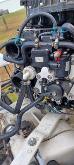

Love the idea. I’ve had both fuel pump and solenoid failures on a 2005 J115PLSOR. The solenoid was replaced with OEM (luckily, still available, but pricey), while the pump was replaced with a premix retrofit kit. That, in turn, got a 3D-printed mounting bracket because the supplied bracket bolted to the rather flimsy vapor tank support, which is no longer available, AFAIK.
And before anyone starts on 3D printing: it’s been almost a year with no visible issues. Just use ASA rather than PLA, set infill kind of high, and make sure that top/bottom/perimeters are adequate. And watch for warping.
Now, someone needs to come up with carb replacement TBI system for this family. That would be a "shut up and take my money!" kind of product. :LOL:
(This is an older iteration of the bracket, replaced after a few days with a redesigned version that is still in use.)

When you say solenoid, do you mean primer solenoid? A premix pump like you installed, is a standard solution. The Maxrules site has those kits as well as OMS pump rebuild kits.
I do like the oil injection on my '98, so I opted to replace the OMS pump last year. I probably could have gotten a few more years out of the original OMS pump, but It was leaking at an oring sealing the mixed fuel outlet.

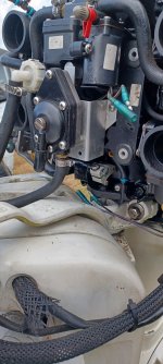

The thingie with the red lever, top right. Aftermarket ones tend to have the wrong inlets.
Yep, I used a kit for the pump replacement - not sure which manufacturer. I wasn’t happy with the bracket bolting to the vapor tank support, so I made a different one that bolts directly to the block. Reused their fuel connector.
