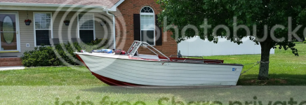

here is my 16' lone star sitting for a few days in my front yard. We lived ona fairly busy road, lots of looks at the crazy man for that week....
