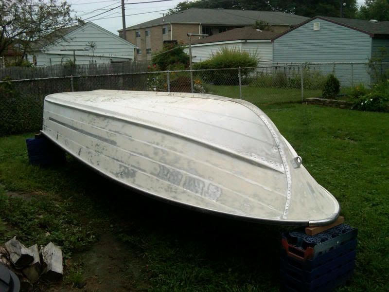

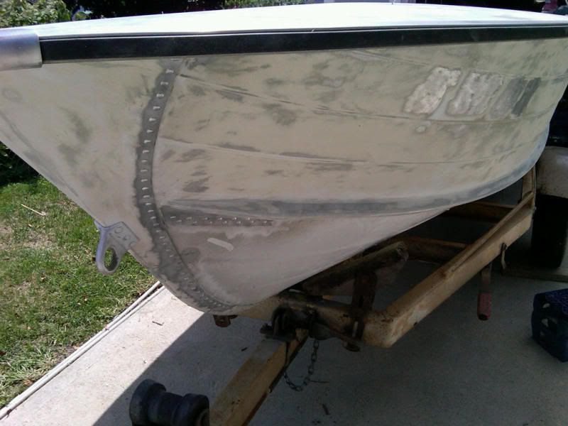

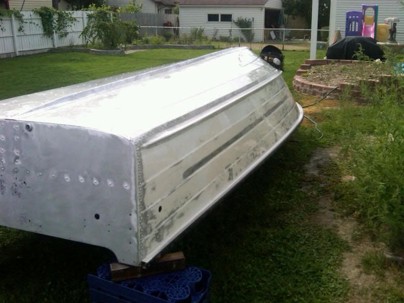

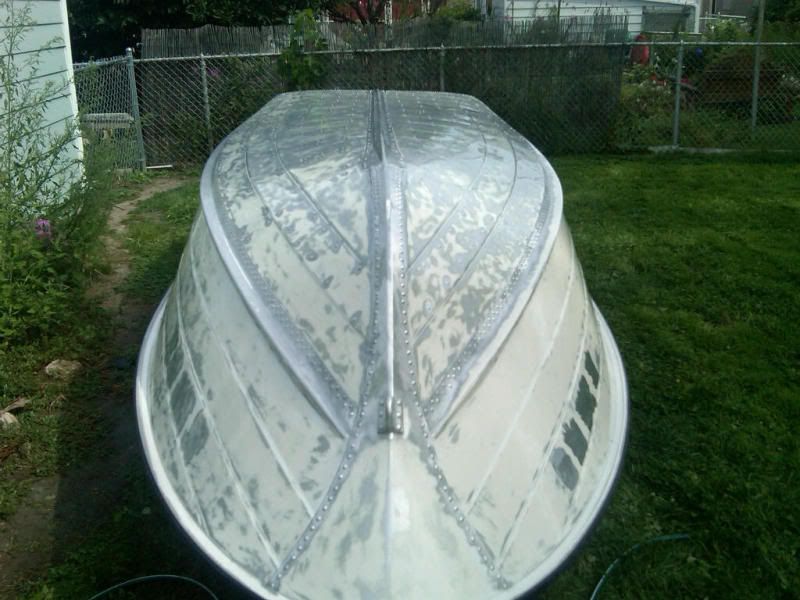

Finally had a chance to get a leak test in and flip her over. The leak test went well, just a couple loose rivits and the obvious three bilge pump holes... However, just for good measure I started wire wheeling all the seams and rivits in prep for some goop. If all goes well I really hope to have the first couple coats of primer and paint on early next week!
Here are a few more pics

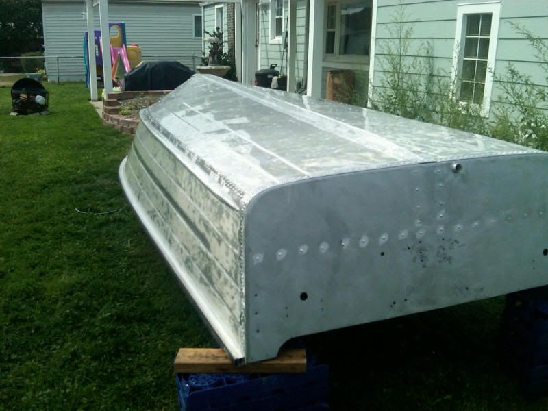

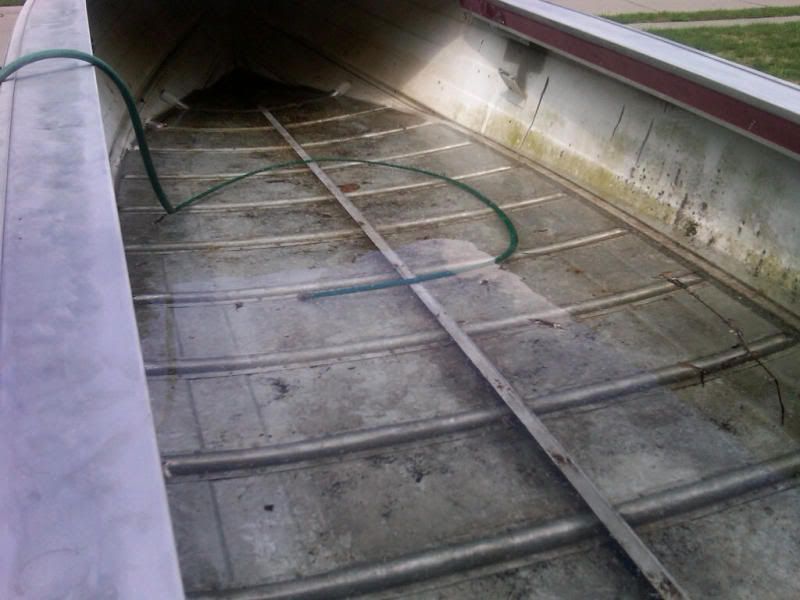

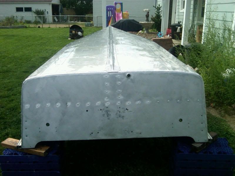

Finally finished all the sanding and wire wheeling on the old girl. I went a little overboard on the rivets and seams, but from my experence with the last project Id rather be safe than sorry. I need to pick up some epoxy tomorrow and start sealing the leaks and what not. I really am amazed at how nice this hull is. I figured I might find some dents scuff marks but to my surprise there really isnt much to speak of. Im looking forward to this weekend and getting a lot done. Epoxy tomorrow, Sat night some primer and with any luck Mon Ill shoot the first coat of white.
Here are some more progress pics... Enjoy!

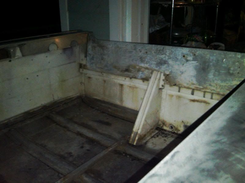

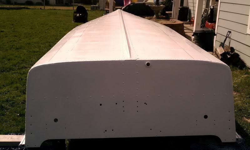

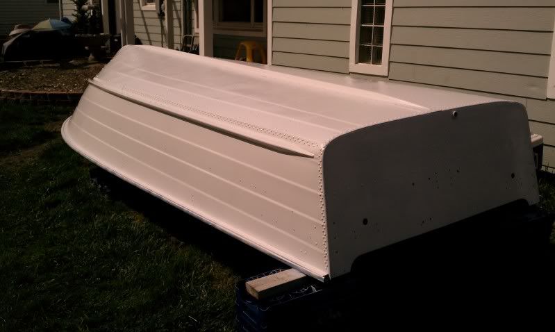

I haven't posted on this old tub in some time, but now that the SS is basically complete I figured it was time to show the old girl some attention. I had quite a bit of white paint left over from the SS build so I used it to shoot the first coat of paint on the Jet. Of course I sprayed a coat of self etching first. I also had a bit of that left over as well.
Here are a few pictures of the progress.

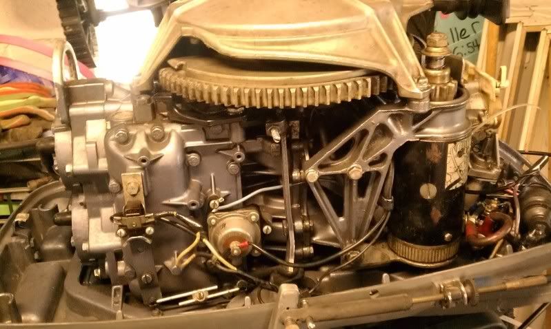

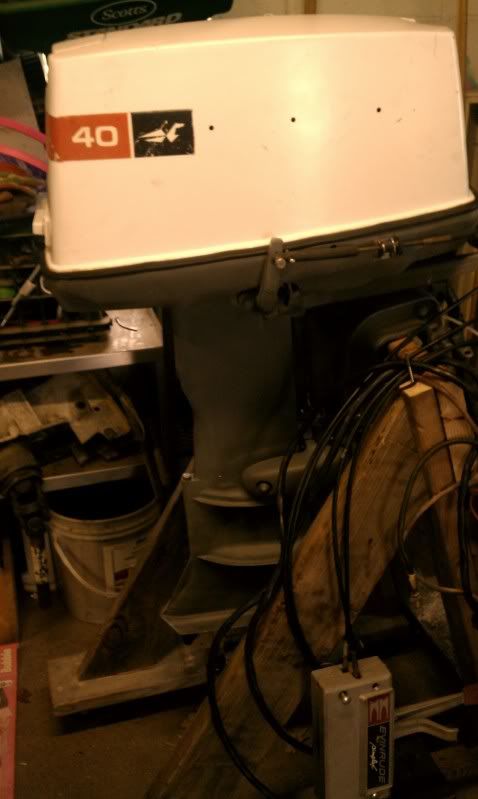

I also picked up a '73 Johnson 40 HP for next to nothing. Came complete with controls, new water pump, and new LU seals.
