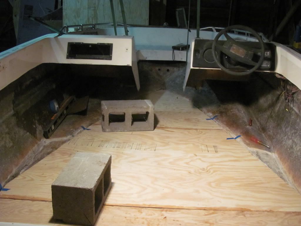

Not a whole lot of progress, but I definitely turned a corner. The deck is down. No screws. I slathered PB on the stringers, and used PL to set up the bi-level living quarters for the gas tank. I have two jobs today, so no boat work until tomorrow. But that will give the PL a chance to set up well.
I did a test fit, and marked the placement with the blue tape. Then cut the tape on the seams and removed the deck pieces so I could put PB on the stringers. The deck was in three pieces. I installed the stern piece, then the bow while standing in the boat. Then the mid section from outside of the boat. That way I didn?t have to walk on the deck until the PB had a chance to set up.
It?s strange to not see the stringers when I walk by the boat. I?ll run fillets along the deck/hull and bilge area tomorrow morning before heading to the lake for some family fun.

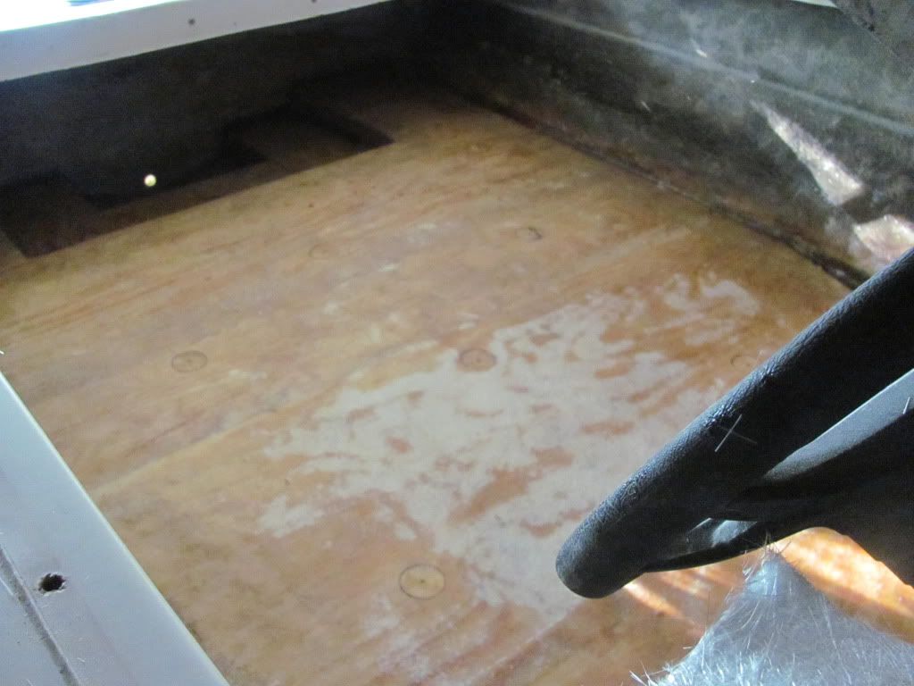

I think the resin is getting to me. I need an objective opinion. I went out to sand down the white glass that was left from the wood sucking up all of the resin. I thought it would be hard, but it was actually pretty fluffy. So I thought I'd try this. I scuffed up the top of the white areas, poured resin over it and rubbed it in. Most of it seemed to penetrate the glass. There is a small area that didn't take. Is this a solid way to fix this? I don't know very much about fiberglass, and I don't want to do something that's not acceptable at this point. This is the first layer of CSM. There will be another layer over this.
Thanks.
BTW - the rectangle light patch toward the bow is light reflection.
