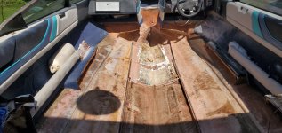

I didn't have as much time as I'd have liked. Still not a lot of light left by the time my workday ends. I stayed out till after sunset, and worked for a while by lantern.
Got a good chunk of the deck out. Got down to the stringers. They are fully encapsulated in what I'd say is the best fiberglass work that I've seen so far on the entire boat... Thing is, the genius that worked on the boat at some point in it's former life used 3 inch deck screws to put down the floor, build a frame for the shoddily built ski locker 'door', and install cross members between the stringers, which I suspect was their answer to address soft spots prior to putting a 2nd floor on top of the old one.
So that decent encapsulation was undone; the inside of the both stringers is basically soaking wet compost - about what I expected to find, to be honest.
I had a devil of a time getting through the decking directly over the fuel tank. I was able to use my oscillating multitool to get through the tabbing that tied the decking to the hull, but had to break out the circular saw in order to dice up the 3/4 ply. But in the end, I was able to expose the top of the fuel tank.20220216_181228.jpg
Encountered a lot of foam. Pulled some of it out. There is some that's clearly from the factory, and is essentially just a water-saturated sponge now. There's also some stuff that seems to still be dry - I suspect it's from the aforementioned repair. It's dry, but seemed to have hastily and unevenly applied.
Lastly - here's how much fuel has come out of the drain hole since I noticed it this morning.
I was able to get more done than there are pics for - namely removing the side upholstered panels (more marine adhesive), including the starboard side one with the control box. Wasn't able to dismount it safely - they used some type of thread lock, and my drill/driver couldn't break them loose. I was hesitant to use the impact driver, as it has some sort of plastic backing plate that looked kind of fragile But it looks like that might be my next step. Got them soaked down with WD-40; maybe that'll do the trick.
We've got a front coming in, so it's not likely that I'll be able to get back to it for a few days. But, given the limited time that I had, I still made progress... Just really wish I'd been able to get that tank out of there.

I started the day wanting to accomplish two things: 1) get the gas tank out, and 2) safely liberate the control box from the upholstered panel that I took out the last time.
I didn't accomplish either, and for a while it kinda got me down. But, looking back on where I started vs where I ended up today, I did get a lot done.
I got all but one of the glued in screws out of the control box. Broke down and used the impact driver which I should have had the balls to do initially. The fourth screwhead, I unfortunately striped to kingdom come. Was going to cut a groove in the head and go to town with a big screwdriver, but broke the last blade for my Dremel. There's not enough clearance (slight recess to the tray it sits in) to get in there with a hacksaw blade, so to the back burner with that until tomorrow.
The gas tank has been literally glassed in place. I'd initially thought that the layer of fiberglass on top of it in places was just where the decking that had been laid over it had delaminated, but that doesn't appear to have been the case. When I finally got to it the other night, it was too dark for me to see clearly, but there was actual fiberglass tabbing over much of it. I peeled a lot of it back but - as if that wasn't enough - it seems as though the stringers have a slight cap that extends over the tank by about a quarter inch; enough to more or less lock it into place.
That was the point where I started thinking about the folks who don't worry about this sorta mess; the myriad of bad decisions and shoddy patch jobs that one finds in these older boats. How nice it must be to just break out the checkbook, then get out on the water straight away.
The pity party didn't last too long; a quick look around reminded me that there were a ton of other jobs that needed doing, that were doable, and would be just the ticket to get me out of the doldrums.
So I started ripping things apart. Not much better therapy than wanton destruction.
Foam, carpet, seat boxes, mulch disguised as structural supports... I got a ton of it out. It looks an absolute horror, but it's progress. And sometimes you have to count those small victories.
After that, took a trip to the hardware store and picked up some more Dremel blades, several blades for the angle grinder (cutting, grinding, and flap disks), and new blades for my oscillating tool. I picked up a pump to drain what I can from the fuel tank, and a few other odds and ends. Retail therapy also helps the mindset when one is otherwise frustrated.
Afterwards, I got back to it. Took out a lot more foam, ripped out more delaminated fiberglass tabbing from the bottom of the hull. Shoveled out more rotten wood. Removed what felt like 10,000 screws. Ripped out more upholstered panels. There's a lot of open space where there wasn't before... It's a welcome site.
Tomorrow I'm going to continue ripping things out. The jump seat boxes are going to be time-consuming; there's probably as much foam back there as the rest of the boat combined (which is saying a lot, there's been a LOT of foam everywhere else). But getting them out will allow me to pull up more of the decking, which will let me get to the back section of the stringers that the gas tank is sandwiched between, which puts me one step closer to getting that son of a gun out. Finally.

That is a lot of progress, and any progress is a step closer to the ultimate goal. Once you get demolition done and have clean slate in front of you it DOES feel good because reconstruction feels great!
You unfortunately had more rot than I had being the front seating area, but in the long run, it may make repairs in the console area easier.
To get my tank out, I removed the bulkheads at each end of the tank so I could walk it out of its home, gently prying on each end.
I didn't have the overhang that you mentioned but did have that fiberglass you encountered plus lots of foam.
I unfortunately don't have pictures at that stage.
I also wanted to let you know that I eventually had the same thoughts about how others ignore problems like this in old boats but still take loved ones out on the water with them.
