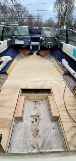

Little bit more progress today.
I feel like I'm taking this thing down to a bare hull one inch at a time. And I believe that I can smell my angle grinder's soul leaving it's body bit by bit.
I'm also constantly amazed by the volume of foam that I continue to dig out of various crevices. Floatation foam or not, the way that it's used seems more structural than not.
I don't know if it's how these boats were designed, but there was a piece of plywood glassed to the hull to serve as the base of the jump seat boxes, and a 2x4 glassed along the side corner. It's an absolute nightmare trying to get this crap out without going through the hull... Slow and steady is doing the job, but it's zero fun.
My seat boxes were just a box glassed to the floor with flotation foam of course but there was additional plywood attaching them to the hull under the side panels.
I used my multitool to cut them out flush to that additional plywood I mentioned which fortunately were in great shape.
I hated the fact I miscut the piece in the back but got reused elsewhere, I think I used 4 sheets of plywood.
