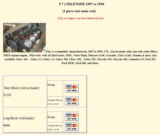

Since you obviously have no idea what goes into a rebuild, here's some pics for you from Rapido Marine.
http://www.rapidomarine.com/

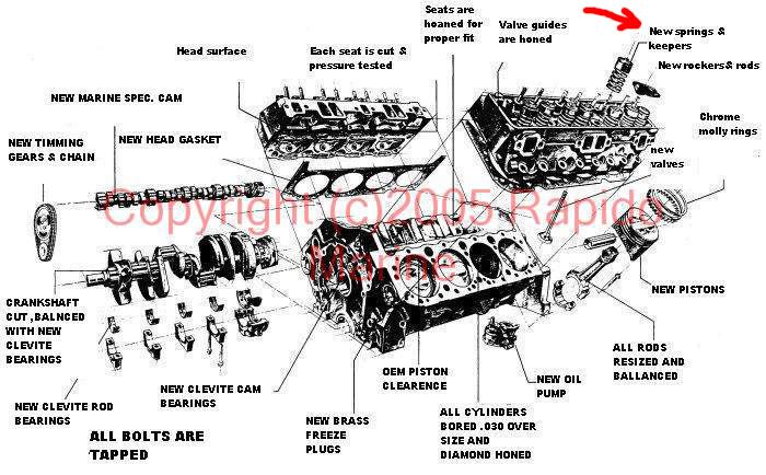

I even added a big red arrow to point out the new valve springs for you since that seemed to be a big concern of yours (maybe they bend the old ones so bad taking them off with your hammer that they have to use new ones!) - even though my 23 year old factory valve springs still deliver the same performance as when the boat was new.
$1450 5.7L GM longblock:
Component view (look for the red arrow!):
