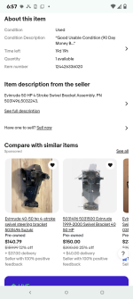

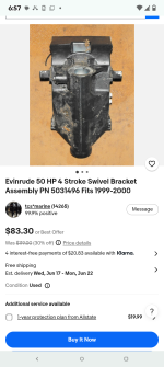

Ok think I found one on the bay, number matches. Do I have to remove power head to replace this?

No , I dont think so but,............honestly I dont know for sure not being familiar with your model , I have done such disassembly on other outboards but there are others here that will know way more than me as to the actual procedure for your motor . Im pretty sure you will need some way of lifting and supporting the weight while you do the job tho 🙂

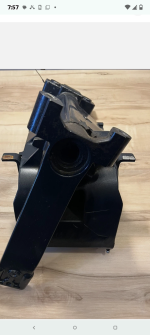

Found this one on e bay must be a weakness in this part it's cracked in exactly the same two places
Ah ,you maybe right . Its good that your vigilant and spotted that before it turned up on your doorstep.
Sux tho that someone would try to sell that critical part with that damage .🙂
You can actually report such sales of defective items to ebay

I messaged to see if they knew it was like that we will see if they take it down
