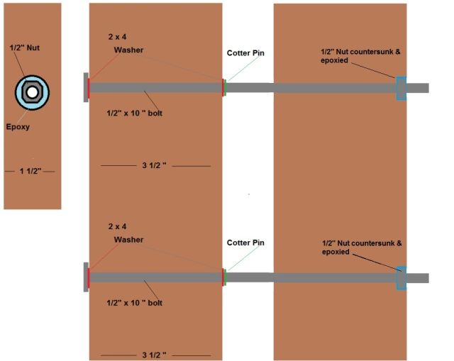

Ok, hopefully this pic will help a little better.
Washers and cotter pin on one board, a nut is countersunk and epoxied in the edge of the other board. To use the clamp you tighten the lower bolt until it is snug on the top of the transom then Loosen the top bolt to put pressure on the lower section of the transom. Once they are about equal then use equal amounts of turns to keep the pressure uniform. Practice makes perfect.

I think i got it now. I sandwiched a 2x4 scrap at the top and only tightened the bottom bolt, it snugged up just fine. O fcourse I will be installing 5 or six of them across the core when it is set in place. Thanks for the help.
WOG - read your post after I posted. I used a nut in place of the cotter pin and used the wedge in place of the epoxy and countersinking. Do you think my system is risky or deficient?

You can use the wedge but it would give you the ability to adjust the pressure as equally IMHO. For PB use 1 qt resin, 1 1/2" qt Cabosil & 1/4 cup 1/4" Chopped Strand fibers. You can cut up scrap pieces of mat and make your own if you have some scraps.
