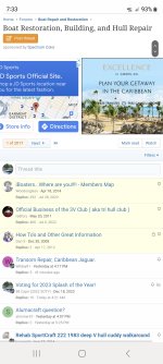

Hey Scott, not sure what you mean by stickies?
I’m new to the forum and currently using on the phone.
Will that make a difference?
88 Capri (2022 SOTY)
Master Chief Petty Officer
Aug 25, 2019
861
In the restoration forum at the top where it says "How tos...."
52,333
Put your phone on desktop mode.
Every forum has threads stuck at the top like post-it notes. Hence the term "sticky"
