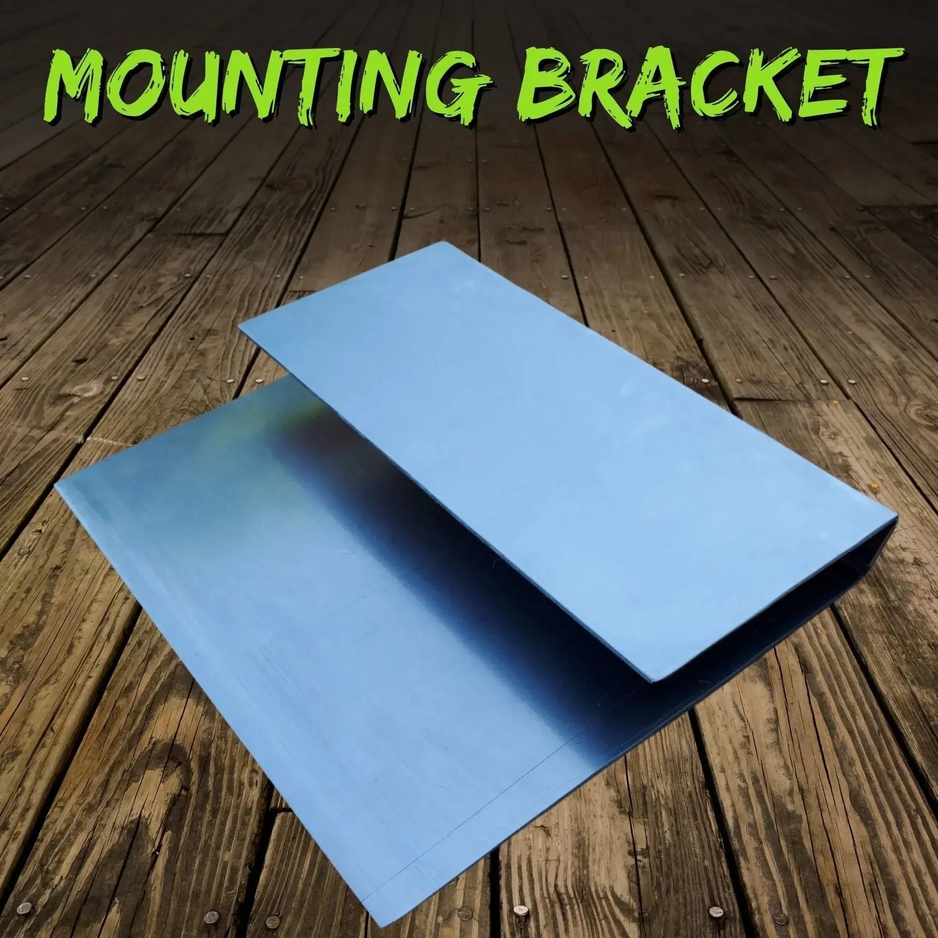

What do you think of this?
People use those to buy time on a Fiberglass boat with a Rotted Transom
