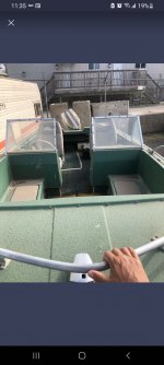

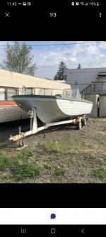

Its a 1969 crestliner not sure model. The is no foam in the hull at this moment. The rot is mostly limited to the rear of the boat. It had been sitting for at least 4 years uncovered. And was sitting pretty level so i dont think it was draining properly

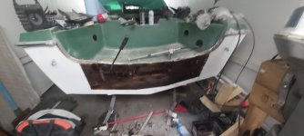

Finally got to opening up the back of my boat good thing i did found more water damage than i had thought. Now starts the chipping and chiseling. Ill keep updating on my progress

I think the biggest flaw is the top of the transom is open with just a metal cap to keep out water. Myself would have wrapped the fiberglass over the transom from both sides that way it would have been water tight from the start
