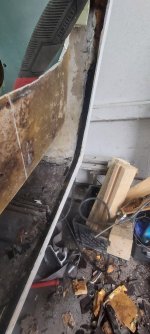

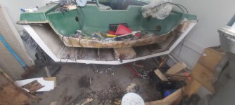

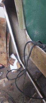

Old transom is completely removed just need to get in there and sand it down a bit,
but just about ready to start putting back together

Nice job! You need make sure you get the fiberglass clean! You need it that way to get the best adhesion.

Yea im gunna go at it with a sand paper block and acitone before i reinstall. Last thing i want is the back of my boat coming off in the middle of the lake

I wanted to redo the transom skin anyways. There were probably close to 50 hole scattered all over the back of the boat, from multiple speed sensors and past steering components various motor positions and set ups ect. With the work im already putting into it, it just didnt make sense to keep all those weak point. As i got into it the inner skin also fell apart from basically becoming swiss cheese, so ill be reglassing both sides anyway
