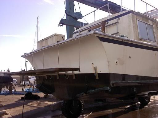

As you all know I am new to boating so please forgive if I am using wrong terms.
I have what I believe to be hydraulically operated trim tabs on the back of my boat. See pic
Since I am going outboard and it will just be able to plane (that's the plan) should I go through the expense of having these repaired?

Converting what appears to be a semi-displacement trawler from inboard to outboard propulsion is going to cost way more than what that boat is worth. You would be far better served by installing/repairing the inboard drive setup. It will cost less and the boat will be able to operate as designed. Converting to outboard drive and hoping it will plane opens up a pandora's box of fun (or hell, depending on your perspective) that you will have to sort through.
And yes, keep/repair the tabs.

To go along with Bob's question, the Trim Tabs inboard edges should not be any closer than 8" from the center-line of the outboard's lower unit. That may have an impact on keeping them where they are.
I think they are Boat Leveler brand Trim Tabs judging from the exposed rubber tubing on the transom.
Here is a link to the Insta Trim / Boat Leveler website, http://www.insta-trim.com I could not find a troubleshooting guide there but they work just about the same as Bennett, so it's pretty easy to troubleshoot them.
Here is the wiring for Boat Leveler.
green=Port
Valve white= Starboard
Valve red=Motor Forward (pump pressure)
yellow= Motor Reverse (pump retract)
black on HPU=Ground
red on Helm=Control Positive
I modified Bennett's trouble shooting to work with Boat Leveler, Here is how you can test it.
1.If one side is not operating reverse hydraulic lines on the front of the Hydraulic Power Unit to determine if the malfunction is in HPU or actuator / hydraulic lines. If after reversing the lines symptom shifts to the other side the malfunction may exist in HPU. If the symptom remains on the same side, malfunction may exist with the actuator / hydraulic lines
2. Is the unit receiving a solid 12 volts? Low voltage will some times cause the solenoids to not open preventing the tabs from moving even though the pump motor is running.
3. Conduct the following test:
Remove the wires from the helm control and touch together as follows:
Operation=Reaction
Positive 12 volts, Red, and Green=Port trim tab down
Positive 12 volts, Red, and White=Starboard trim tab down
Positive 12 volts, Red, Green, and White=both trim tabs down
Positive 12 volts, Yellow, and Green=Port trim tab up
Positive 12 volts, Yellow, and White=Starboard trim tab up
Positive 12 volts, Yellow, White, and Green=both trim tabs up
If the trim tabs function correctly for each wire grouping then the switch is at fault. Also note that any loose or missing screws on the back of the switch (whether a wire is connected there or not) can cause the pump to malfunction.
This test may also be done right at the pump by using a hot lead. There is usually a connector to the wire harness within a foot or so of the pump. You want to check this connection for corrosion. You may wish to cut the connector off on the pump side and try the test on bare wires.
If you suspect corrosion on the wire connector near the pump, cut it out, test as above and reconnect using butt splices.
I thought this might help you get the Trim Tabs operating.

Get the trim tabs fixed. They are an assest even when you're not on plane. They can assist in leveling the boat when loads are offset, they can slow your idle speed when you're in a sensitive area, and help you cut through rougher seas a little better.
Remember to put them all the way back up prior to backing down to a slip or shoal. Having them down while doing this will affect the reverse handling chacteristics.
