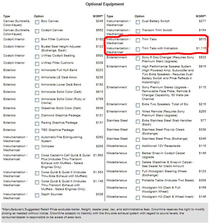

I believe most people don't want to pay the factory prices for the option. For example, they were a $615 option on my 2003 22' Crownline, $1115 if you wanted the indicator (and the original owner didn't get them). Kind of like paying $1000 for a factory high-end stereo on a new car when you can go to Best Buy and get something twice as good for 1/4 the price.

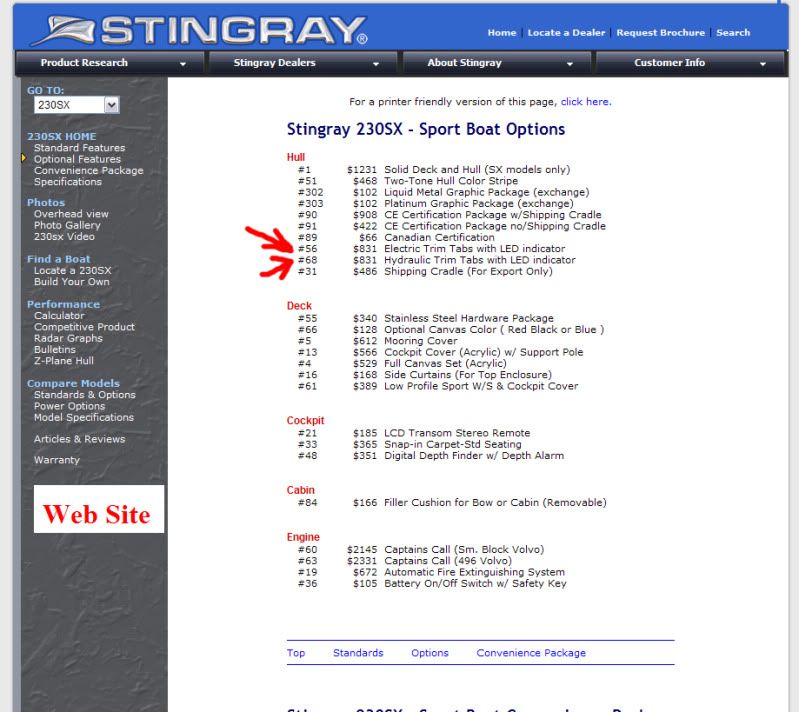

They're an $831 option (hydraulic or electric) on 2010 23' Stingrays:
http://www.stingrayboats.com/products/models10/models.php?model=230SX&action=2
