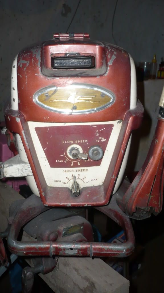

One question... Why is there written (near the choke) ''pull to stop'' if you can stop the motor by turning the gas/steering handle?

Great news JohnRudeMan. I'm not sure why the choke would say "pull to stop", however. Are you sure it doesn't say "Pull to start"? You generally have to choke the motor upon cold start ups to provide a "rich" mixture to the motor, but once the motor has warmed up, you usually don't need to use it again. Although, I suppose you could kill the motor by pulling the choke, thereby flooding the cylinders and causing the motor to die, but I've never done that. Many of the older model OMC motors, without factory kill switches were designed to be shut off by simply turning the throttle all the way down to its lowest position thereby decreasing the spark to such a point that the motor died. Congratulations again on the progress. Keep us posted.

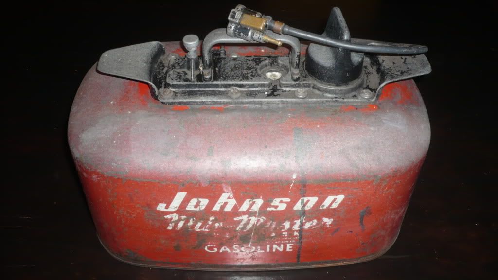

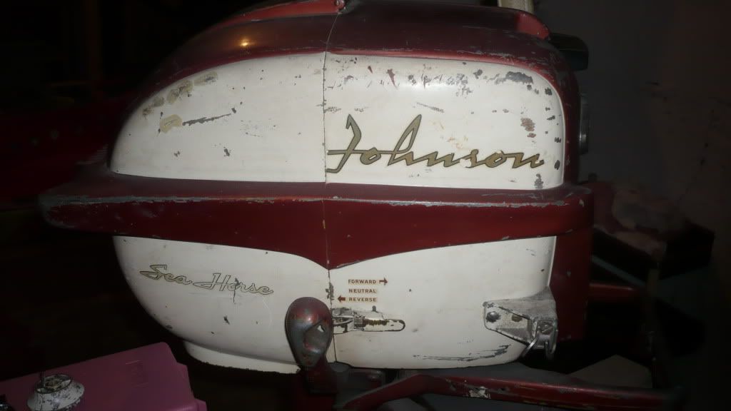

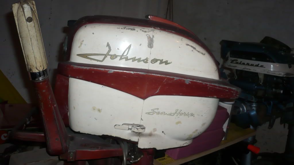

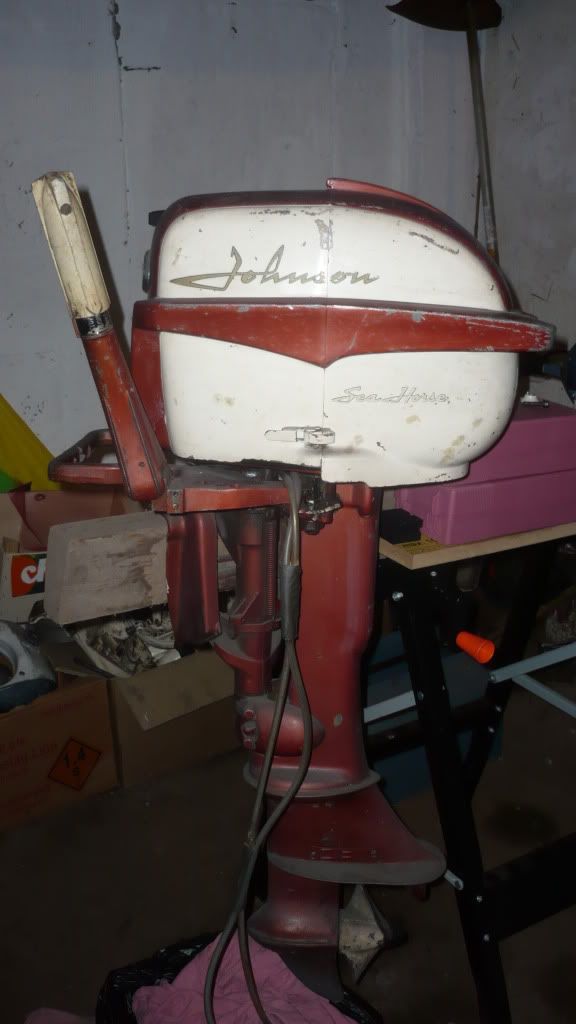

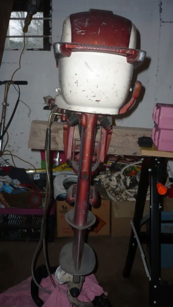

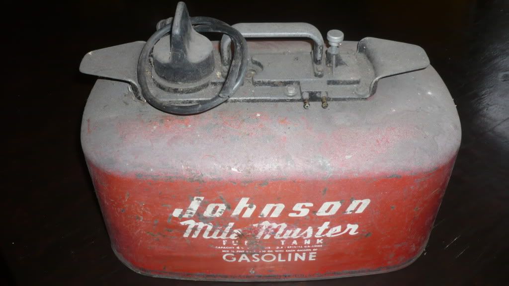

Nice score! I see that it still has the 1958 Emblem on the front. The tank looks like a 1954-55 with the metal primer button. One thing I notice in this picture: http://i1097.photobucket.com/albums/g348/war-searcher/P1030008.jpg is that there is an original OMC accessory adaptor for fitting remote controls.
The stop button was only installed on the 10-horse and larger motors back then.
Your motor looks like the very same model as my 7?. I'm curious as to why there is no horsepower decal on the cowl of your motor.

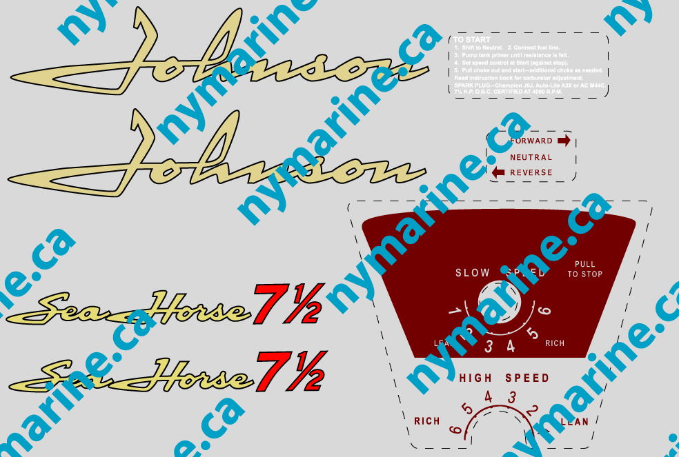

@kfa4303: I'm sure it says 'pull to stop'. Here is a link to the motor decal: http://www.nymarine.ca/58JO75WEBPIC.gif
You can see the 'pull to stop' is there too. This is my motor: http://i1097.photobucket.com/albums/g348/war-searcher/P1030007.jpg
@TN-25: I think you're right with the tank, it's certainly a 1955 tank. The previous owner has told me that it was the original tank, so I assumed it was... but you're right it's a '55 :D.
The 7? hp decal has simply disappeared through the years of sitting (about 20 years)... as you take a closer look, you can see that there must have been the 7? decal on the side of the motor.
I'll try to take a picture from it :).

so it does. I suppose they just used the choke to flood the engine and get it to stop. Funny, because in the decal for the starting instructions tell you to pull the choke to start the motor too. Go figure. Keep us posted.
