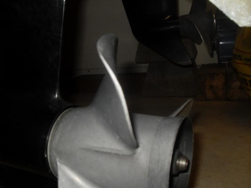

There is a visual bend on one of the prop fins and the fin itself is completely polished aluminum from spending it's whole life running sand bars in the bay. So, being I can't afford to upgrade the power and it needs a new prop anyway... can someone shed some light on a prop that may help the higher rpm's and planing out without losing low end power?
Second post
But being the prop that is on there is original and has a pretty good bend in one of the fins, I figured it may be irrelevant? And was going to either have this one fixed or pick up a new one.
And again in the second post
For now, it needs a new prop so I figure maybe try and see if that could help for now.
Intention of the thread was being that the boat is under powered and in need of a new prop anyway, what would be a good prop to help it plane out until I can upgrade the motor.

I already checked the Mercury prop selector, and (like I posted before) it said a 9 or 10 pitch Black Max aluminum or Vengeance(SS) prop.
How does that compare to what you are running now?
steelespike
Apr 26, 2002
19,069
If they were running in shallows often making contact with sand the prop may actually be worn undersize diameter.
I think a 9" pitch is a good bet if we are making a pick without a base line test. Perhaps a 4 blade.

Go back to near the top and re-read Steelspike's "gotta haves". Once you do that he can run the numbers against a prop slip calculator and make a fairly close guess for the pitch of your replacement prop. If you don't have a tach, buy a "Tiny Tach". He needs the WOT rpm number with your current prop even if it is damaged.
