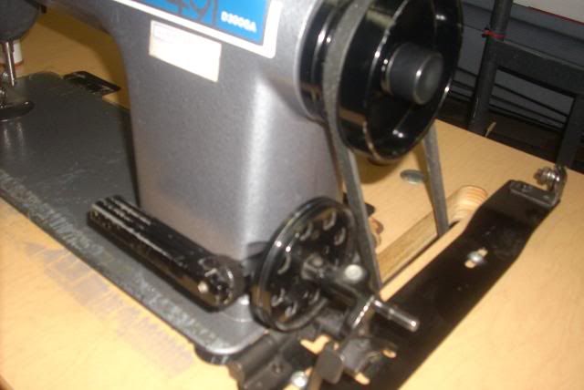

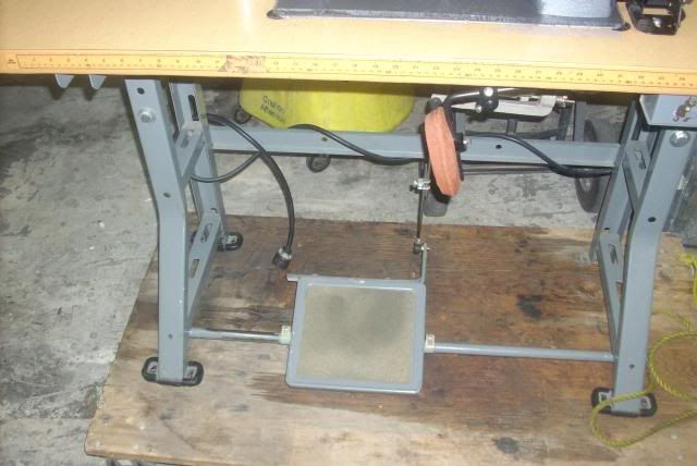

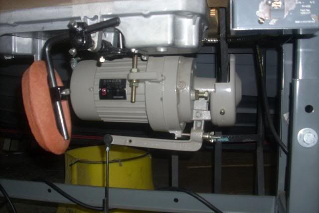

this is my machine
this is the motor....lol
the gas pedal
the black lever at the base is the reverse
