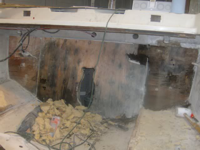

Ok, made a lot of progress tonight. I got the skin off the inside of the transom and here's what I found...............Quite a lot of rotted wood. You can see where I drove the wrecking bar pretty far into the double layer of ply on the port side. It's all rotted under there. Looks like the lower starboard side of the transom is the same.
I dug out the whole port side of the single layer of ply. Didn't take all that long. Needs some more work with the chisel and then I'll be grinding.
Suprisingly, as wet and rotted as the port side is, the stringer is absolutely bone dry.

Progress tonight was to work on getting the wood off the transom. Started by cutting a grid with a skill saw set to depth. Then worked on prying out some of the sections. Most of it is really wet, quite a bit is rotted.

Man, be glad it's mostly rotten. Dry transoms are a b!!$!@# to remove. Yours looks like mine; easy to get to and a nice, basic shape.

yeah guys, the access is really good. Big enough for both of us to sit up under there with grinders and tyvek suits, john!!!!! haha. Dueling Grinders?
Danond, yes, the shape is pretty basic. The rotted wood sure comes out easier than the dry stuff, like you said.

Got a lot done on the boat tonight. Thanks in part to my friend Paul who has been helping me an awful lot lately. Much appreciated. We got the transom cleaned off to a smooth thin layer of ply on the glass. There was a lot of wet and rotted wood in there. Looking pretty good now.........
We got the front 3 bulkheads out........the remainder of the starboard stringer and all the foam on that side as well as the forward compartment.
Things were going along really great until some freaking bonehead cut through the hull with a sawzall.........yep, me.
I started cutting the foam back under the bow deck. Water had been trapped in between the front bulkheads for who knows how long til i discovered it. The foam was only wet for a few inches back in there, so I don't have to dig all that out. Just need to put in new bulkheads
In all a pretty productive night out there!
