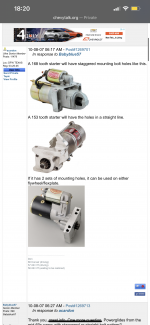

Did you see the one on the link that Scott shared? It says 168 tooth but 12”. That’s why I was confused. I wonder which is the typo, diameter or tooth count before I order it.
I stole this from a Chevy forum. Does that seem about right?
