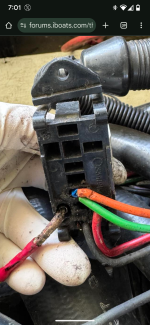

I'm getting no power to the fuel pump, if I put direct power to the fuel pump it will run. Engine starts after pumping the throttle several times and stays running obviously until gas runs out.
I checked power at green wire on the alternator and I am getting 12V. I checked power to the green wire going into the fuel pump fuse holder and I do not have any voltage. The orange wire I am getting 12V to it. The black negative wire going to the relay holder I am getting 12V.
I looked at some diagrams and it shows that the green wire is supposed to go from the relay holder straight to the alternator but it did not look to be going there. I took off almost all the electrical tape and it looks like they are separate.
I just bought this boat and the electrical was a bit of a mess with some wires having been open which I redid the connections to see if that was the issue which it was not.
I replaced the relay as well and did not make a difference.
I spent a few hours trying to figure it out and I don't recall if I tested whether or not the negative wire going to the fuel pump. The 15 amp breaker I checked as well and there's 12V going to both terminals.
I tested the wires both in the start position and when I was cranking it and there was no voltage going to the red/yellow wire to the fuel pump or the green wire going to the relay holder for the fuel pump.482681545_1365966368017886_5146632888258617083_n.jpg491119484_1178062967096033_4654238611979129623_n.jpg490986959_531788526407823_2213725812059030078_n.jpg485976582_2885566651615255_1234125298339799922_n.jpg491279826_647504591420510_4953743551435877321_n.jpg491001456_709201745283803_7303165940262149551_n.jpg

Which GL do you have? GL A, B, C.....
The GL uses 2 diodes to provide fuel to the fuel pump. One is inline with the Green wire and the other is inline with the Orange wire
You should not have 12V on the Black wire because that is ground. With key OFF use an ohm meter and check resistance from Black wire on relay to ground, you should read zero ohms. If its higher than that you have a broken ground wire

Sorry not 12V I checked the positive wires and they all had 12V, just not the fuel pump yellow/red wire. Would I just check continuity on either side of the green and orange wire where the diode is to see the reading for it?
I'll check resistance next. Just need to youtube a video to double check. I didn't check any resistance at all.

Just don't know if that pump is continuously on when the engine is running or not.
Ayuh,..... It should pump when starting, 'n when the motor is running,....
alldodge
Mar 8, 2009
44,428
The pump should run full time when motor is running
Might just be the relay
Key ON should have 12V on pin 30
When cranking or motor running should have 12V on the Orange or Green wire (this can be pin 85 or 86, the other pin will be black ground)
If you see 12V on the orange/green pin and do not have power going from co to 87 (yell/red) then the relay is not working

Yes so I had 12V on the orange/green pin. The orange wire individually only had 12V and the green did not have any voltage. It's possible the other relay I put was shot as well. I'll have to check with a new one. Getting it towed in today with the sellers other boat so I'll finally be able to pull the engine serial number and crawl inside again to check it out.

Thanks got it sorted out, I grabbed another relay off a cracked engine and that ended up being shot as well. Replaced it with another and now I have 12V running to the yellow/red wire on the pump.
