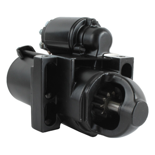

not sure how reputable this company is but they list a compatible PGMR starter for $107
11 tooth clockwise which is what i need.
Starter for Marine Applications PMGR 12-Volt CW 11-Tooth, 50-807904A1​
alldodge
Mar 8, 2009
44,649
Many have bought DB Electric, should be fine
You will like that it weighs less than the old model and it will spin the motor faster
