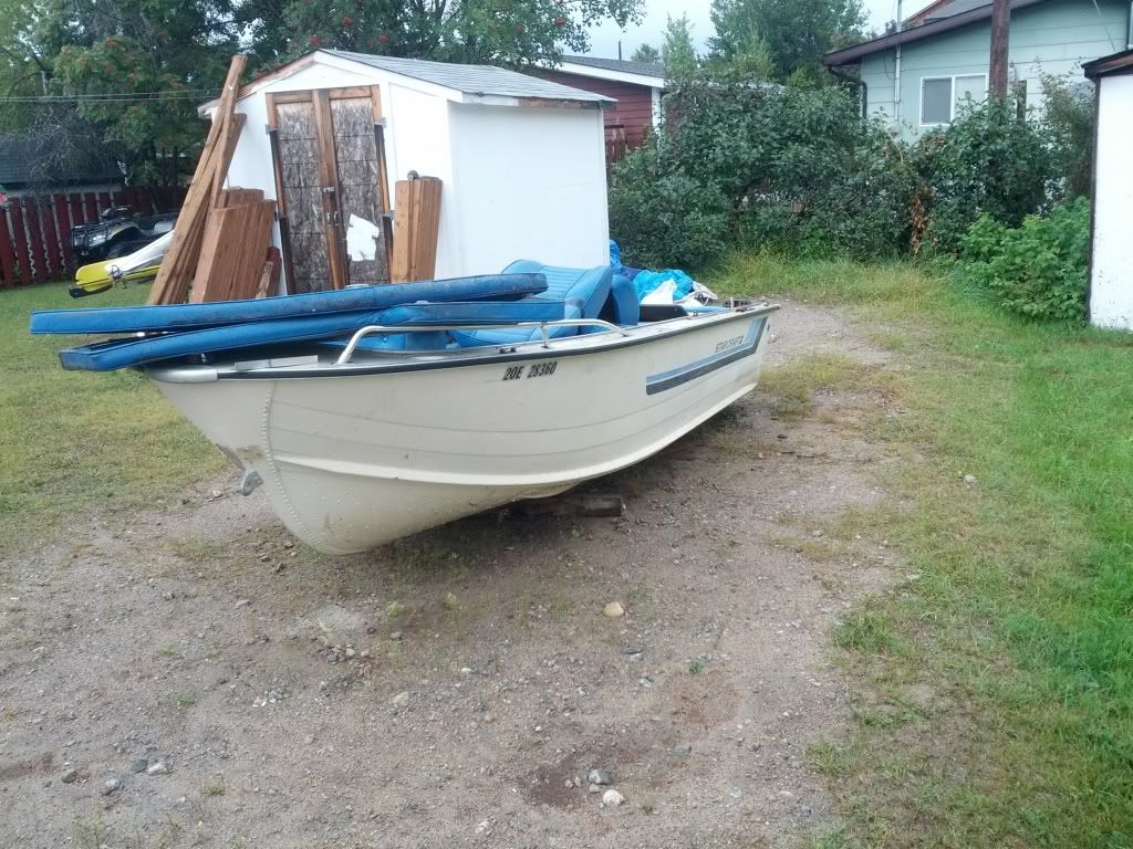

I unfortunately don't have current pictures of the poor neglected starcraft, but here it is circa 04:
The top and bow tonneau have been off of it and in the garage for years, and are still in good shape, if they haven't shrunk to the point they no longer fit.... LOL

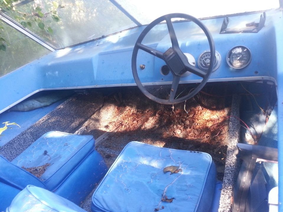

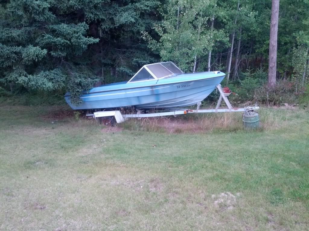

Re: Well, here goes nothing, SS160 Rebuild

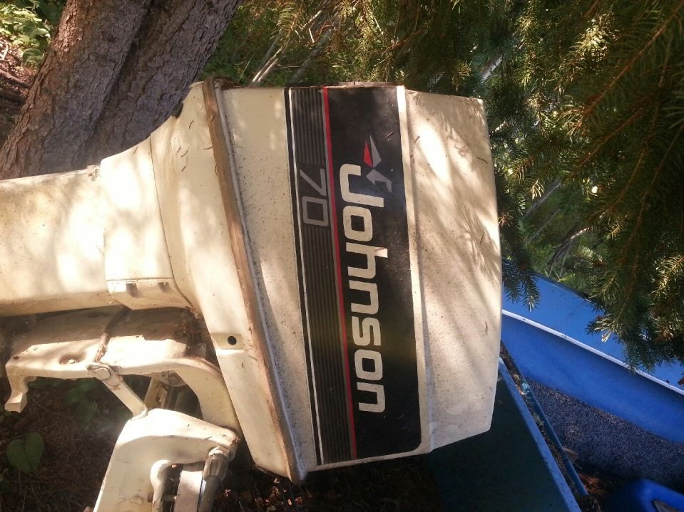

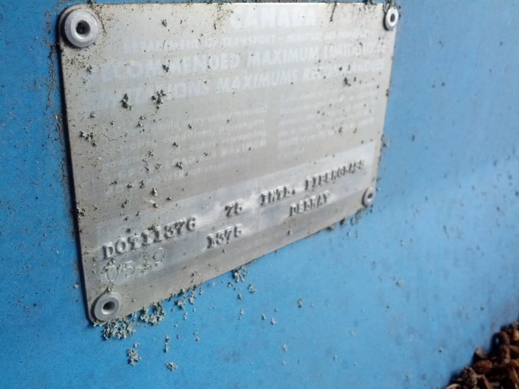

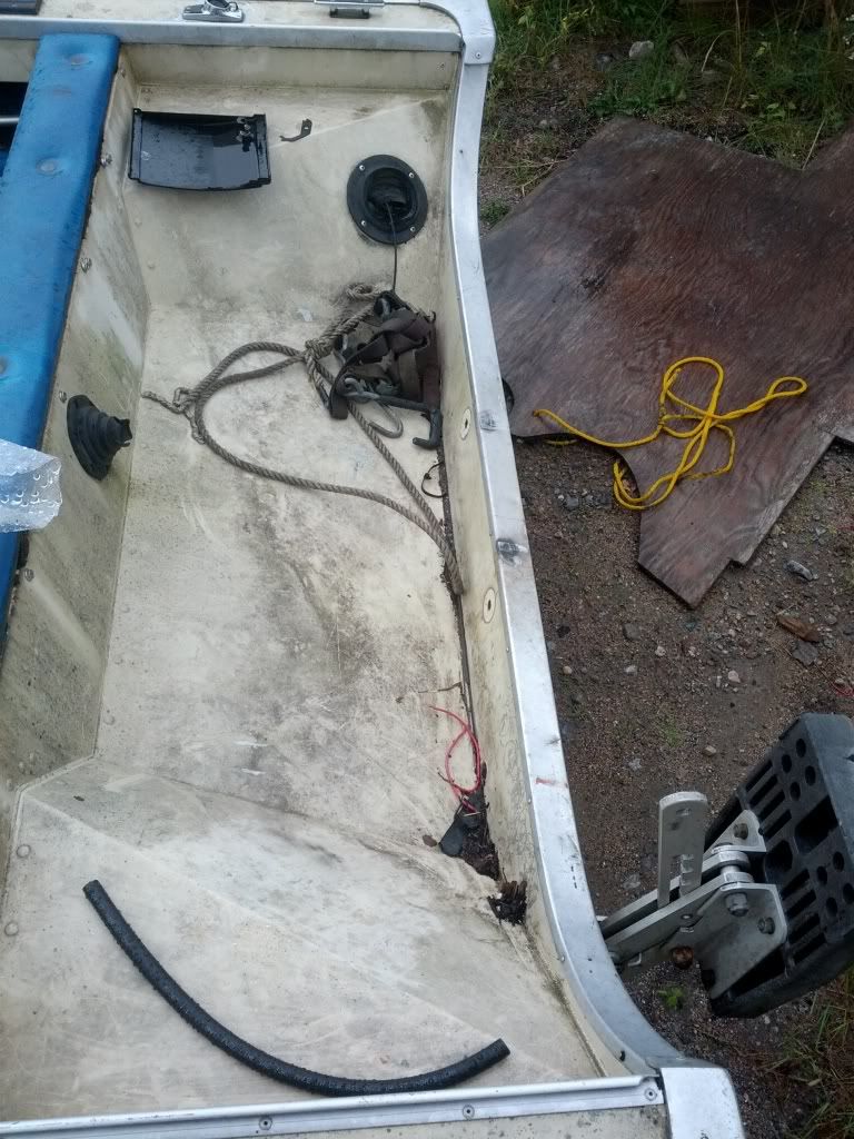

Well, I went and took a look at the donor boat. I haven't seen a transom that bad in a while... LOL
Someone was mid engine removal when the project was sidelined. Controls are un hooked and the motor is partly unbolted.
Even if it was bolted down I would be scared of losing the motor if I was going more than the few hundred feet I will be going.
Never ran across that manufacturer before.
Motor is for sure a 1990, nice and clean under the hood, it isn't seized and it feels good turning it over by hand. I will get the compression gauge out once I get it attached to something solid.

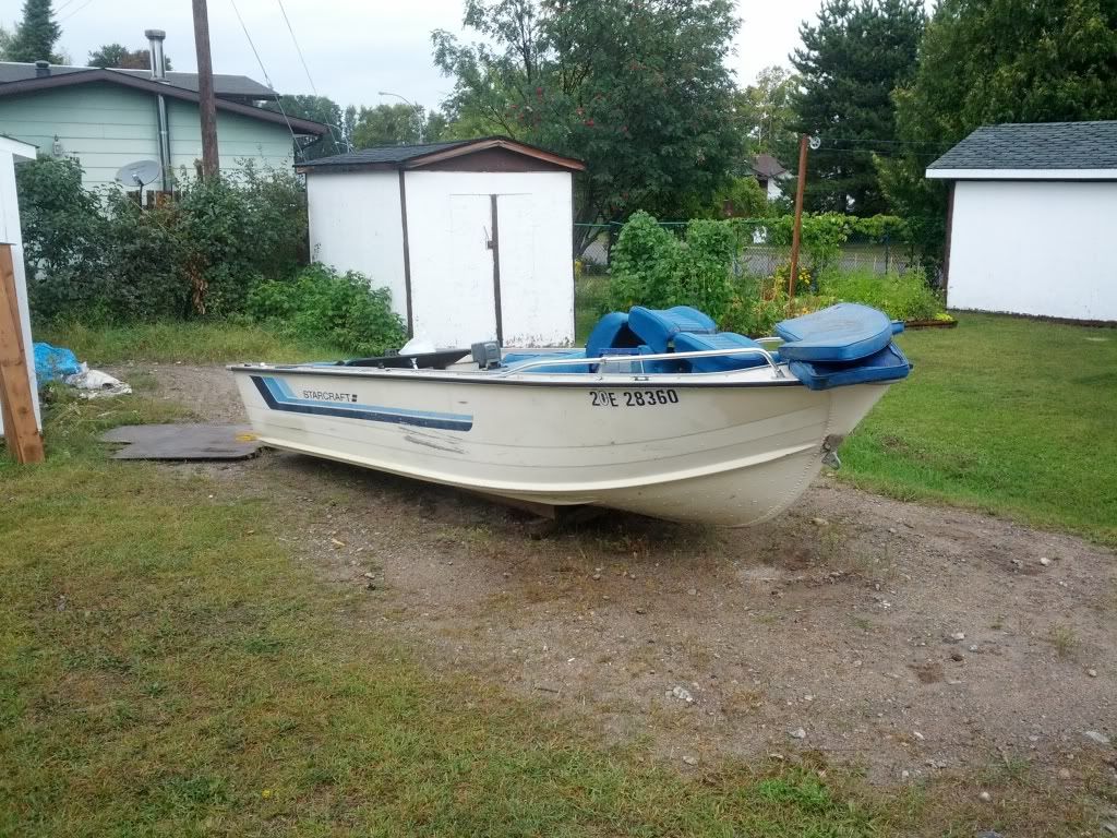

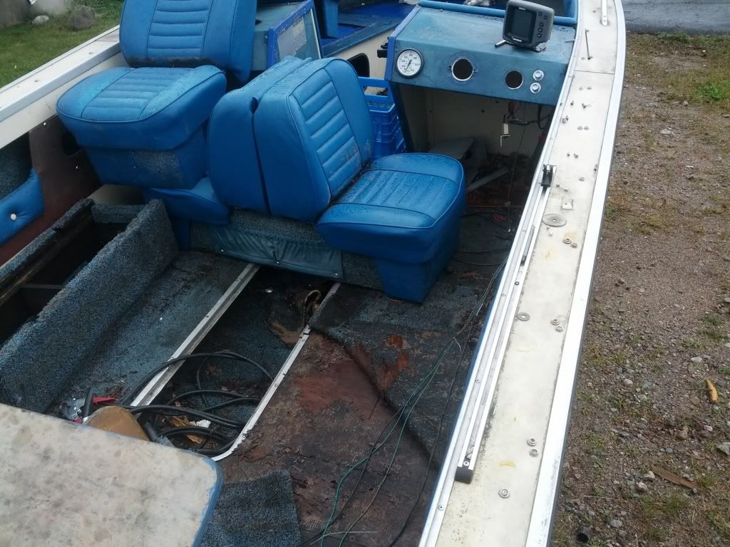

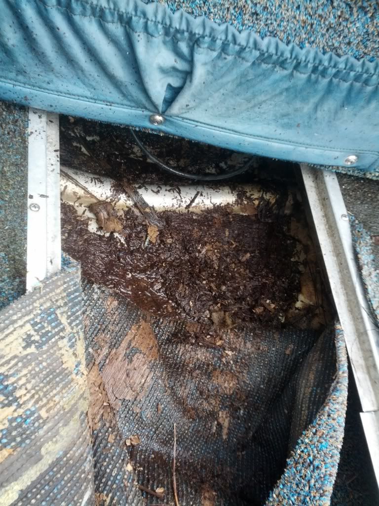

And now for my poor neglected SS:
I looked at the seats the right way and they came loose... LOL
I'm starting to think I won't be removing the old floor in big pieces... LOL
Not a crack or mark in the splashwell or any of the supports, transom wood that I can get to feels/looks useable, but I will change it this winter. If I can get it on the water this fall, it will get used as is.

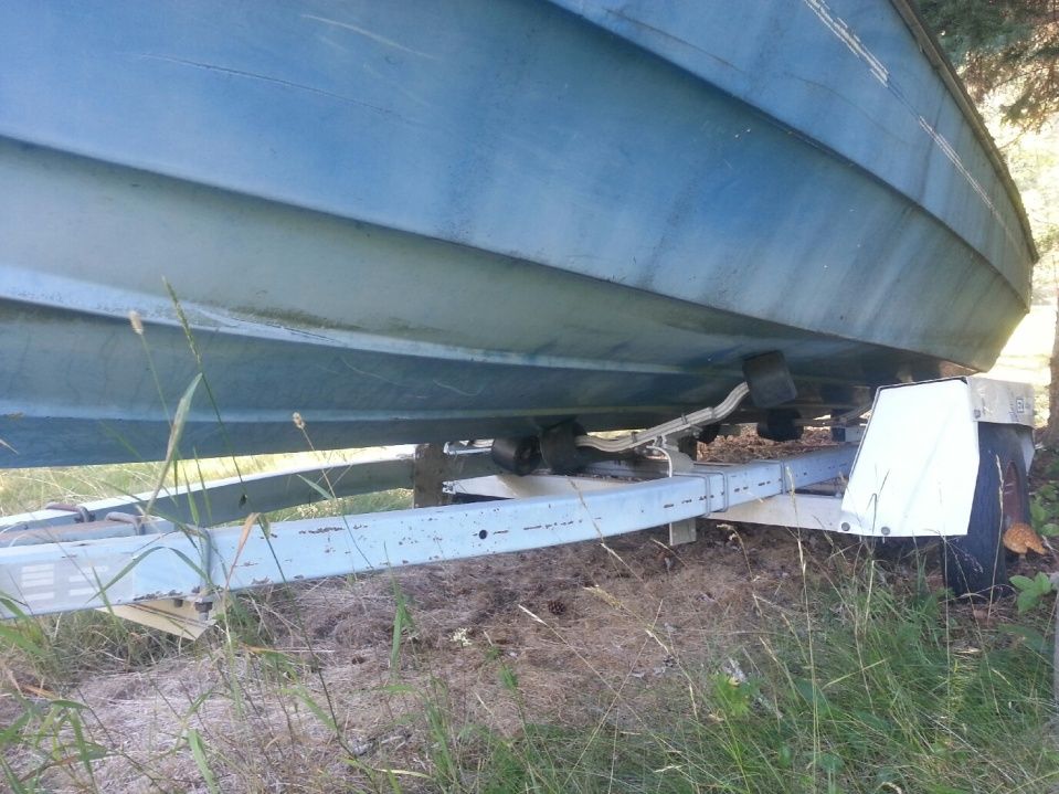

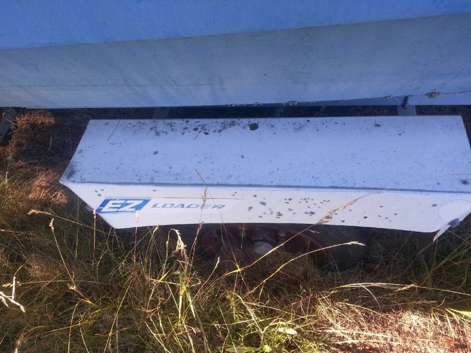

Well, a whole $100 later and I have the donor boat at home... Trailer tires even hold air... LOL
It definatley isn't 100%, but I'll be damned if the thing doesn't run. I did nothing but hook it up to a battery and a tank of good fuel, pump up the bulb, prime it and turn the key.
http://youtu.be/BLWuqmdovTE
I haven't put a compression guage on it yet, but the top cyl is definatley low. It isn't completley dead, as it is running on it, so, there may just be hope of saving it. T&T works nicely, was rebuilt not long before it was parked, lower unit shifts nicely too, skeg is broken, but that isn't a huge disaster. Prop is mangled, but, again, not a deal breaker by any means.

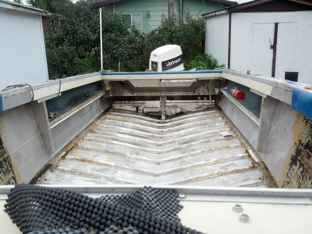

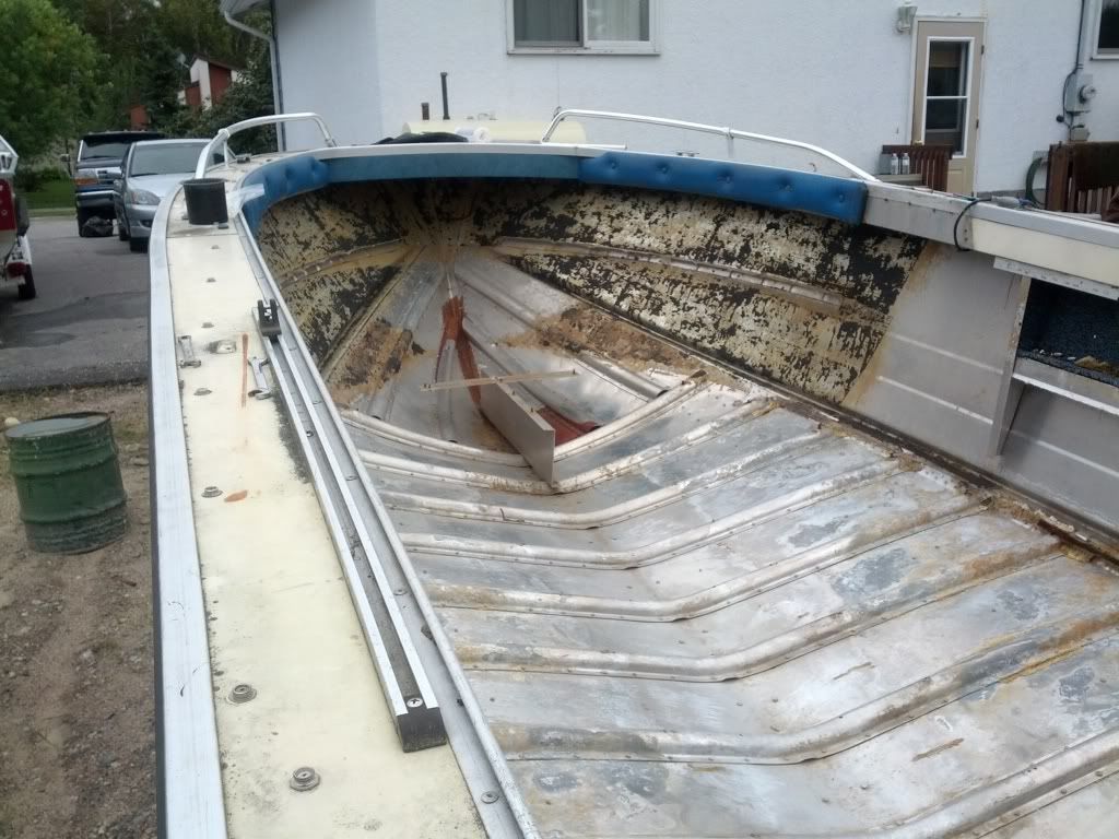

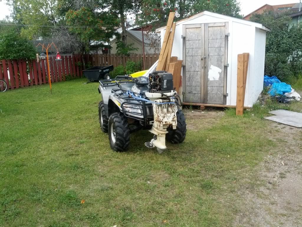

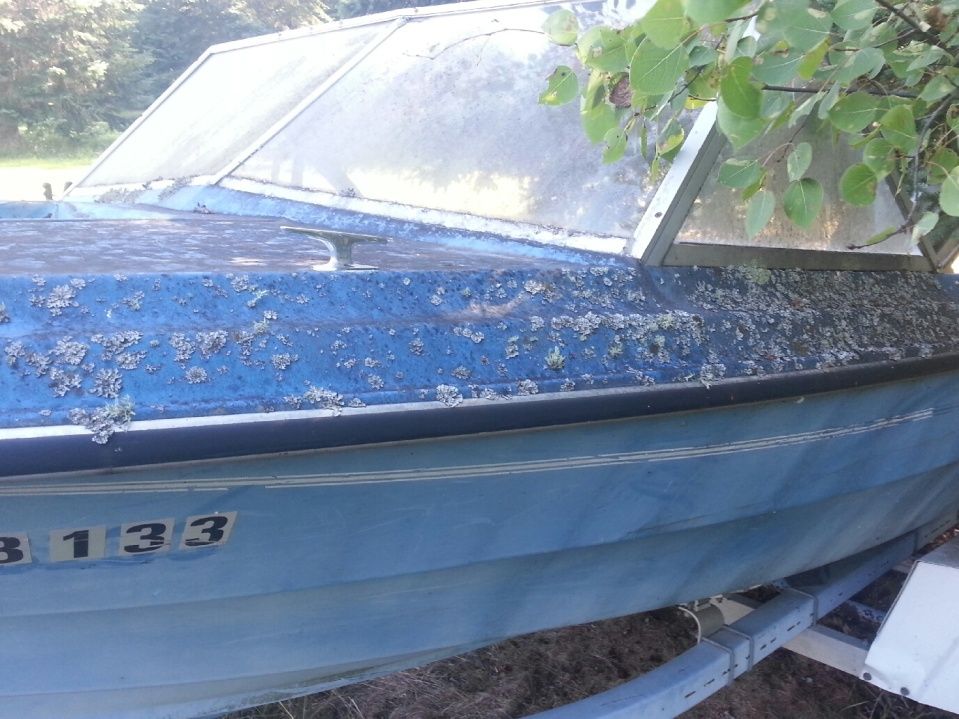

Made some good progress today. Glasser is gone, floor is on its way out.
I was without an engine hoist at home, so I improvised:
64osby
Jul 28, 2009
6,826
"Necessity is the mother of invention"
Won't do much in the water, but it might help you in the deep swamps.:thumb:

Well, weather got in the way of progress. So until next weekend it will sit like so:
Not a loose rivet or a leak in the hull, below the rotten wood and foam there is a nice solid boat.
