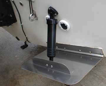

The item in the photo is indeed a Trim Tab. Specifically it looks like an 18" x 9" Bennett Trim Tab. To me it doesn't look mangled, it is in the fully down position meaning that it is holding pressure.
Bennet makes v-shaped trim tabs? It looks like he backed into something in the driveway to me.

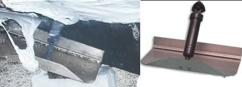

I'd agree - it looks crumpled to me. Either way, back to the OP, I think there are two trains of though here and you need to tell us which track you are persuing - a listing problem (boat leans to port or starboard under accelleration), or a steerage problem (would be yaw in aero speak) where the boat steers to a different compass heading on acceleration. If you could please clarify, I'm sure suggestions will be forthcoming.
I must be missing something, I am getting older so maybe it's my eyesight! But here is the OPs photo next to a picture of a brand new 18 x 9 Trim Tab:
Fireman431
Sep 17, 2007
4,292
Re: What are these called?
The OP's pic didn't look out of sorts to me either. I was wondering what everyone was talking about!!

Ok. Remember, the picture taken was NOT off of my boat...
Ayuh,... Hi Tom,... You guys have changed yer design,...
Mine, 'n those I've dealt with are pretty Flat, all the way back, 'n the ram is retained by a bracket, rather than the big bend in the plate itself...
It looks like they're easier to build, but gives up about 1/3 of they're ability to do what they're there for...

Hi Bond-o,
Actually we have been making that type of Trim Tab since Bennett was founded.
We make two basic "standard" Trim Tabs, ones with 9" chord (fore to aft measurement) and ones with 12" chord. Depending on the space available the 9" chord ones are more efficient, but they take up more side to side space. If there is not enough space to fit a long span (side to side measurement) 9" chord Trim Tab, then a shorter span 12" chord can be used.
On the 9" chord Trim Tabs the actuator (ram) is attached where the trailing edge is folded up 90 degrees:
On the 12" chord the actuator is attached to a riveted angle (you must have 12" chord Trim Tabs):
Since the riveted angle is the same distance out from the transom as the folded trailing edge on the 9" chord Trim Tab a 12" chord can be installed on a boat that had 9" ones, without having to move the actuator.
We also make a lot of other shapes and sizes, some custom ones for boat builders or like these M120s for installation where transom space is limited:
Bondo
Apr 17, 2002
71,463
Ayuh,... Gotcha Tom,... Thanks,.. Mine are 12"....
Never really noticed the 9"ers being that way...
It makes perfect sense, in that the rams are the same...;)
