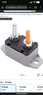

What is the correct name for this breaker?
53,303
Notice the two colors of lugs on the small breakers.
The copper lug is the batt connection
I'm not doubting that the polarity exists, it's why. Fuses don't have that. My understanding is that breakers break either because a bimetallic strip heats and deforms breaking the connection or with an electromagnet that breaks when enough current is applied to the magnet to trip it (not sure how prevalent that is in a marine environment). In either case conceptually it doesn't make sense to me why it matters which wire is on which side of the circuit. I had a fuse on my lift that didn't blow until after the housing had melted some. Looking for a better solution so have been thinking about breakers more than normal I guess
53,303
I don't know why, I just know that they do.

Guess I got the correct terminals by chance.Been out several times with no issues whatsoever. No markings anywhere and I looked with a magnifying glass to be sure.
All good ,cheap fix so let's see if it lasts. Tested it today and all good. Saw the exact same looking breaker selling in several places and probably all exactly the same but I bought the one that stated waterproof marine from an RV /Marine center. Charlie
