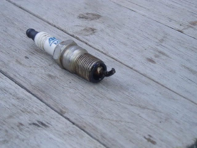

This was the end result of what I believe was a hung-up lifter.
Fought this problem for about a year......thought I fixed it after I loosened the rockers......then 1 day while cruising at 3600RPM.....bam...........came to a sudden stop! Basically took out the entire engine.
Here's a pic of the plug from that cylinder.
And of the piston.......found pcs of the valve through out the engine.
