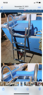

Here’s what it looks like I’m solid blue. I’m pretty sure I got this photo from another build on this forum. Not sure who the builder was but I really like the boarding ladder/platform. I’m going to do something similar if I ever get me lazy butt off the couch.
My splashwell is already flat in that area, so that could work for me too. I think some add-ons will need to wait for 2023 though. Maybe we'll see how many times the portable ladder that just hangs over the side gets used. Off to roll a slightly thicker coat #2 shortly, if I can find my way to the shop in the fresh snow!
