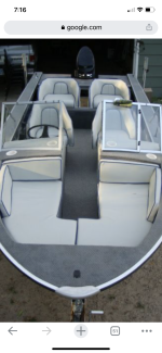

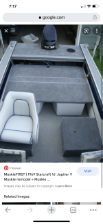

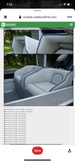

Looking awesome. Can’t wait to see your switch layout. I’ve got the same one to install. I’m going to try and upload some pictures of a star craft project I saw a while back. (15 foot Jupiter to a SS conversion I believe) It’s a pair a short bucket seats on a plywood platform. These fold over to create a casting platform. Kind of neat. Not sure if it’ll fit your intended use (can’t recall if you were going sleeper seats or individual pedestal)
In any case, the concept could be applied to a simple bench, or fold up jumpseats. Much like the newer boats do nowadays.

That's a cool set-up for sure. If I had more of a fishing focus (and didn't need to access fuel tank under splashwell), that'd be great option. I'm hoping to set up a simpler bench seat that can fold down to give maximum cargo volume behind the front seats. The bench would need to be pretty shallow to fold as I'm imagining, making it more utilitarian in nature. We are water-access, so we're always hauling people, baggage, food, water, etc back and forth. The trip is relatively short though, so some less luxurious but more compact seats might be in order.
I might try mocking up some options tonight if time allows.
