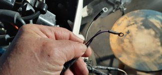

Pictured below are the 2 wires I question , they come in the harness that wraps around the inside of the engine, there appears to be only 1 plug in. Once I plug in the only plug in that fits there 2 wires lay at a location determined by the length on the wires and I c no place for them 2 hook up. Never got the key so I had to order new switch. The 2 wires are purple and lite gray., the black wire has been clipped off. They both have a fitting on the end where a small screw would go thru

Grey tachometer wire customarily goes with the yellow/grey stripe wires on the terminal strip. Black would be grounded. Not sure where the purple connects on this model. Book says solenoid (?????)
