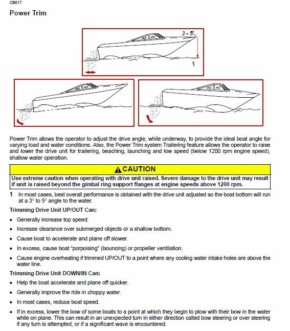

3) - Trim - Possibility. Haven't played too much with the trim. She gets on plane in a hurry, and that's what makes me happy.
If you've got it trimmed all the way in so it gets on plane in a hurry, then you're not trimming up as it comes on plane, that could be a MAJOR cause of your low RPM and low top speed. If you're not trimming up once on plane, you're forcing the bow down and causing lots of drag like in the bottom right pic below. You should be trimming up till it looks like the top pic below once on plane.
Once it's up on plane, trim the drive up till it barely starts to porpoise then bump it back down a hair till it stops. That will be the optimum operating condition at that speed. It will vary slightly at different speeds - that's why you have adjustable trim.
From the Mercruiser Owner's Manual:
