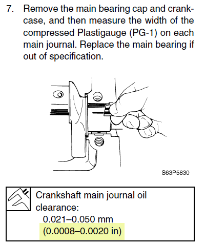

All of the main bearings for the 63P model Yamaha F150's are available.
Why not get one of each colour and measure its thickness.
Then measure the diameter of each crank shaft main bearing journal and the block bearing bores to calculate what size bearing is needed to achieve the specified clearance?
Then use plastigage to either verify the clearance is correct or not.

now wait im sure you had a typo there, but just to be clear 7 thousandths is written as .007'', not .7'' which is seven hundred-thousanths! Again im sure you meant .002''-.007'' just thought i'd make sure! But if that one bearing is .006'' you should be fine, no?

The manual says 0.7 to 2 thou clearance on the mains. I figured if I would be around 1.5 that would be golden. I went ahead and made mistake #1, I ordered some ACL race bearings for a 2.3 Duratec/mazda cx-7 (the bearings that came out of block #1 were all good, and all had ford part numbers on them). Since yamaha uses different bearing colours, I needed to find a manufacturer that made that bearing in under/regular/over sizes in 1 thou increments. Only ones I could find was ACL. When the bearings came in they mic'd at about 8 thou clearance - WAY too much! Uhh that is when I found out that ACL race bearings come standard as 1 thou over, and I also bought the HX variant, which is another thou over!
But wait... that still brings me to 6 thou if I buy the regular variant - still too much! I am kinda just stuck at this stage thinking if I should try get the mahle standard size, or just say screw it and go visit the dealer (I got super lucky with my block/crank combo, all the bearings are the same size!)

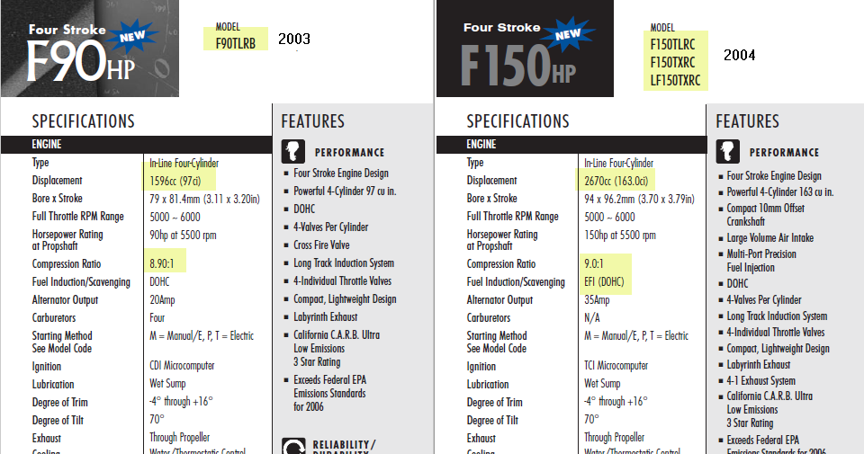

Have you a link to the Yamaha motor that Mercury used in a 90 HP version?
The Yamaha F90 and the Yamaha F150 are completely different animals.

Something is not adding up.
The carbureted Yamaha F90 was first offered in 2003. Identical to the Mercury 90 HP carburetted four stroke.
The fuel injected F150 was first offered in 2004. Not offered by Mercury.
Completely different motors. The F150 using a bigger block. Different crank shaft. Different bearings. Very little parts commonality.

sorry mate , my bad , i got the 2 motors mixed up on those last posts.
