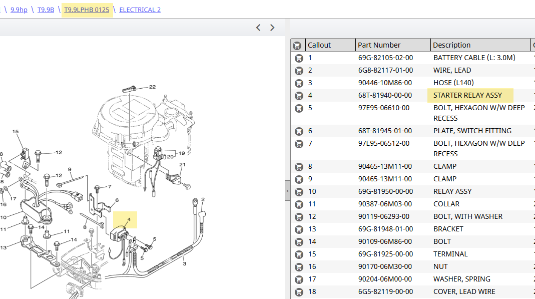

What is the complete model identity. All T9.9s are not the same.
Start button or key switch?

Don't all Yamaha outboards have an in-line fuse that will prevent power to solenoid? Does the motor have a "dead man" lanyard?
boscoe99
Aug 22, 2013
2,399
Most Yams have circuit protection for starter motor relays.
Those Yams that have a starter motor solenoid activated by a starter motor relay do not have circuit protection for the solenoid. Only for the relay.
All Yams have a kill switch to stop the motor. Either when the key is turned to off position (part of the key switch), a button is pushed, or when a lanyard to a stop switch on a panel or part of a control box is pulled.
