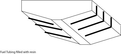

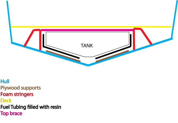

My belly tank was sitting two pieces of plywood that where glassed to the hull held in with foam. I know I know that fuel tanks should not be held with foam.
So I was thinking of ways to to allow air to around the tank and help water get to the bilge area so here is what I am planning on doing unless someone shoots the idea down :(
I still plan putting glassed plywood down first to help spread the load on the hull, but between the plywood and the tank I would fit pieces of fuel tubing filled with resin to create a solid cylinders as the spacers, these should not rot. They even could be made so that each spacer could be shaped to come up the sides of the tank and act as side spacers too.
Your thoughts iboats please....... :D

Resin filled fuel line to secure the tank ... Im thinking your over thinking this :) ..
What is wrong with foam filling your tank in ? ..
The top straps can be buffered with cut/strips of hose..

Too many bad reports, plus my tank area had no drainage and was foam filled and as a result had a lot wet foam under the tank. Granted, it had that setup for 31 years before I got my hands on it :)

It depends what the fuel tank is made from, alum needs free air ventilation and should not contact rubber due to the carbon in the tubing.
I glued the tank (60 gal) to the 4 cross supports with PL, its solid.
Nothing else touches the tank all around.

Yeah, my tank is aluminium, here is a diagram of the old setup:
and here is my plan with the resin filled fuel tubing"
underneath view
if I can get away with 'just' foaming the tank into position that would save some time and hassle. ;)
