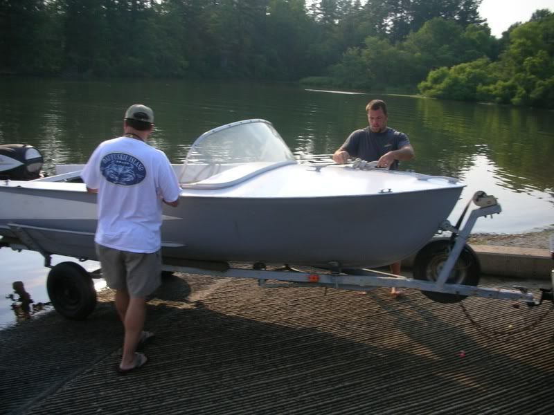

Hey fellow boats. I decided to go with Rustoelum Marine paint for my boat and I think I made a good choice after everyones thoughts and suggestions. I know its not the Tennessee Orange but I love the red. The pictures that follow are the first coat. I have put one more coat since then. My goal is to put 4 to 5 coats on total. Also If you remember there was a white stripe on the side. well in the pictures that follow it doesnt show it. But today I decidded per my wife and other iboat member to keep it. It goes with the boat. So today I masked off the white stripe to get it ready to paint it white when i am done with the red. I will keep the restoration pics going. Its getting closer and closer to being put back on the trailer!!!!!!!

OK gang. I have done alot of work since My last post. As you can see in the photos. I took apart the old gray trailer and repainted with Rusto.. I rewired the lights but for some reason I am not getting any light from the side lights. Any suggestions?? I am getting the brakes and tailights. but no side lights. Also I am finally done painting the hull. 5 coats later and it is time to flip it back on the trailer. Almost done. I am starting to paint the topside and arrow on the side with Rusto Marine White Gloss. I will put 4 coats on this and put a nice red stripe down the top deck. Take a look at the pics and tell me what you think!!

Hey guys. Just a quick update. I have finally FINISHED PAINTING~~~~!!! Tomorrow after work I will be reinstalling the motor and cables. Almost there!!! I really appreciate having this website to document my journey. If it wasnt for this website I dont think I would have taken so many pictures or have done such a good job.. All your advice and ideas worked really well. I do have another question though. I am replacing the windshield with another plexy glass windshield. Will the stuff at Lowes and Home depot work. I wasnt sure if that stuff will bend to form.. I have a local glass shop I could call to see if they could do it but I wanted to do it myself. Any thoughts veterans????
