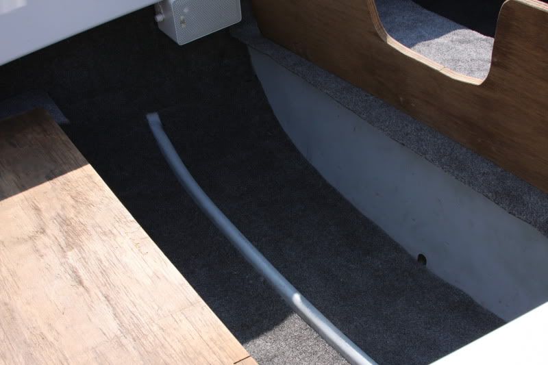

HEy gang. Got some new pictures to post. The Old boat is doing well. I havent posted in awhile because I havent been able to do much with it. But have been on here looking at everyone elses progress!! I finally figured out the whole battery thing. Since then I have started working on the carpet. I got my hands on some outdoor industrial floor matts that are 4x5 feet long. I think these will be great and hold up better than the cheap stuff from lowes. they were alittle pricey but have solid thick rubber backing. I do have one question. I have noticed that when i hit a wave a little bit of water comes in at a couple of rivets. The rivets are on and around the ribs that run across so its hard to see which one exactly i need to seal on the bottom. any suggestions? i was jus going to sand them all down and seal them all. since they are under the water no one is going to see them. Also I am in the market for a electric trumpet style horn to put on it to keep it vintage. any suggestions as where to find one. ebay is a hit or miss. I will take some pictures of the boat tomorrow to show the progress so far. THanks guys..

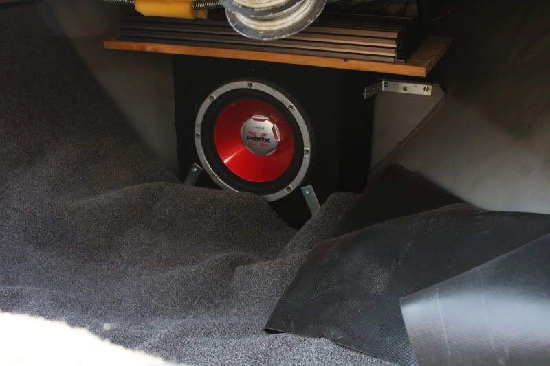

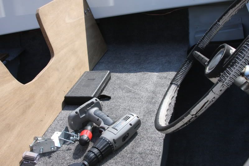

OK HERES the update so far. the carpet will go between the ribs. i did this because it would be to hard to keep the carpet down on them. i am giong to paint the ribs black and gray to match the carpet. ALSO YOU will notice the sub box and speakers i installed.

i have not put the carpet down. i am going to cut all the pieces before i start gluing it down.

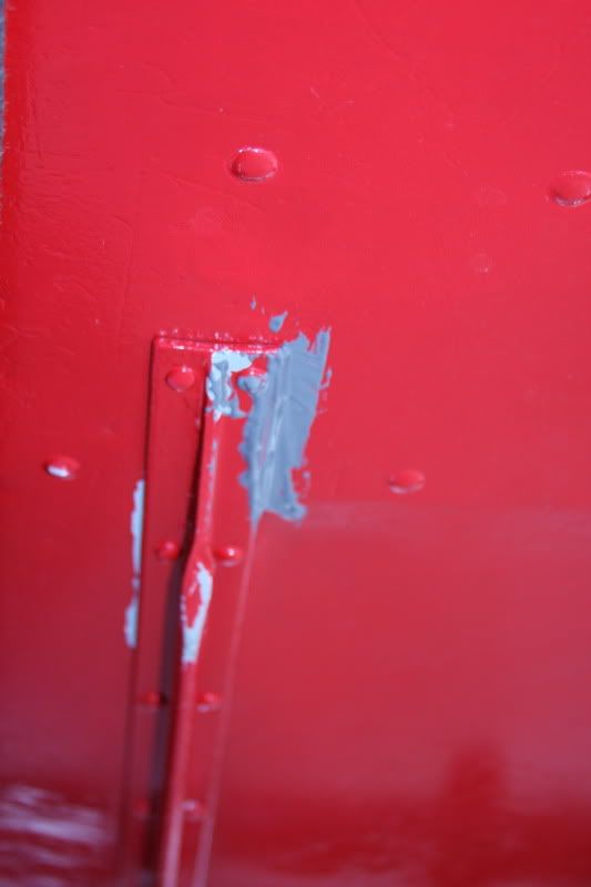

I ALSO had a small leak at a rivet i couldnt to front the inside so i took jb weld first and then marine epoxy over that. hhopefully this will work.

The JB will work just fine. I have used it on mine for some inaccessible loose rivets as well.

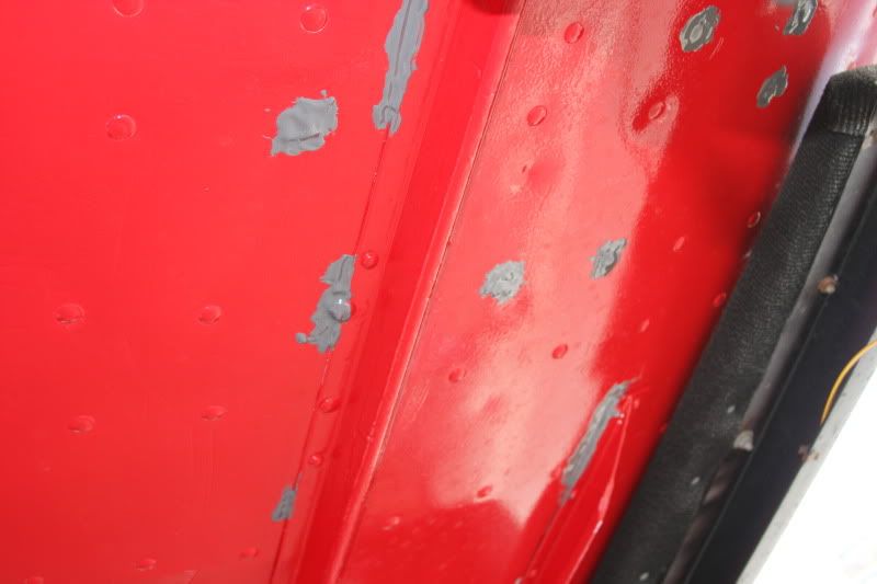

Well After spending all that time trying to seal all the rivets i thought may be leaking, I decided to take it out for the week boat triip. Well Come to find out it is still leaking. I Still dont know where its coming from..

Stick a hose in it in the driveway. That's what I did and it revealed a pin hole that was underneath the transom knee brace. What wasn't dripping it was streaming out!

Thanks for the help. BAD BAD NEWS!!!! well after inspecting the underside of the baot, everywhere i put jb weld , it cracked or came off!!!!! This is not going to work. I need to figure out how to seal the one rivet that is leaking. i was thinking since its aluminum and so old that maybe when i hit waves the boat is flexing and causing the hole to open up. because before i put jb weld on it , it olnly leaked when i hit a wave. so who knows!! As far as the seats are concerned i took good quality treated wood and sanded down the edges. I also prefer the pass throgh. it is much easier and more appealing than a solid back. I plan on buying the cooler cushions in white. one that is 96qt for the bottom seats and then two smalls one for front back rests... i will have to check out that website out about the horns..hows your boat coming.

You can try bucking that rivet tight, with a small sledge and bucking bar, or you could braze over it. If it's flexing enough to shuck off the JB Weld, might need to apply a small dab of tar...ugly but it sticks and works forever. Thanks for the input on the seats. The Texas Maid is coming along...hope to water test with two 57 OMC Big Twins soon. Got the topsides painted, larger gas tank for running twins, plumbed the tank to feed two motors, and mounted easy-connect battery posts to the transom. One of these days, I'll find the seat configuration that I like and stop messing with it.

Hey Gang I need some advice. The Weather has finally warmed up enough to start back up working on Graysea. Well I took her out Saturday and found where the leak is coming from. It is actually coming from the keel. I tried last year to patch it with JB weld and it popped off. Any suggestions on how to fix this leak forever. I didnt know if I Should just get a welder to fix it or what.. Help!
