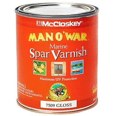

If you want to save some money, this stuff is pretty darn good...
FJ_Russo
Mar 14, 2010
350
Re: 1960 Luger Matador Restoration
Thanks for the info! I have heard a couple other posts about the man o war I haven't found a supplier yet. But it's a thought, thanks!!

My plans are to use as much from the donor boat as possible, and yes that 35hp was the main reason for the purchase!! I love the looks of the engine. It's a 1958 and has a fuel pump and a 12 volt charging system, so all the modern updates but has a sweet vintage look! I ended up buying a gallon of epiphanes for my varnish. I really gave some serious thought to the man o war. I even found a store in my area that could order me a gallon. I just wanted the tried and true advantage of epiphanes. The blue got a bit darker after drying. So Im happy with it now. I did a second coat today, stripped down the trailer and am wire wheeling it now. More pics in a day or so!!
