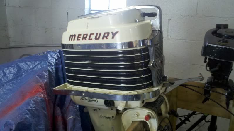

Rats on the LU crack. Hope it isn't bad and can be fixed.
InMotion
Nov 3, 2011
2,080
Re: 1964 Starcraft Jet - Rebuild
Yah...it leaking gear case oil out and I can see the crack open and close when I move it... When I return from the lake i'll snap some shots to give everyone a clearer picture. Top end looks brand new... Really is virtually spotless!!! One way or another it'll live to run again!!
Anyone know if I can swap the inards to a long shaft doner to keep it a short shaft... Hope that makes sense... It's a short shaft unit now... But most Lu are long shafters....
Typing on my phone ya know!!!
Cheers!
Gibbles
Nov 14, 2009
2,050
Cheers!
From the mercs I have, the lowers are the same other than the drive shaft.
but if I recall correctly... you have to remove the prop shaft in order to get the drive shaft out...
so you might as well replace all the seals while your at it, and have the other LU welded while it's apart (just say'n lol )...
GA_Boater
May 24, 2011
49,038
What Gibbles said. The mid-section and drive shaft are shorter. The water tube and shift shaft are already in the mid-section. You should be able to get an empty L/U housing and swap the shaft and guts. If you can see the crack opening and closing :eek: not a good sign. Might be hard to weld it up straight. And maybe not, what do I know?
jbcurt00
Oct 25, 2011
25,356
Dag nab it, I was really hoping it was a surface manufacturing flaw.....
What yr/ser# Merc is that? You could look thru the 500 Mercs over here & run down the LU years that match up to yours, but it'd be quicker to just post up in the Merc forum..
jbcurt00
Oct 25, 2011
25,356
And I don't know if there's a LU to fit your's but this was posted yesterday..........
http://detroit.craigslist.org/wyn/boa/3313589705.html
I have the following lower units and other outboard parts:
a. Boat Propellers omc johnson mercury 10 - 150Hp
b. mercury outboard boat LOWER UNIT ----4 40 50 65 70 80-140 200HP
bb. OMC johnson evinrude LOWER UNIT 30-140hp 1957-87 manual and electric
c. Yamaha LOWER UNIT ---40 70hp merc base, yam 140-220HP LOWER UNITS
Have a great Sun!
dozerII
Oct 25, 2009
6,527
Hey Jim, bummer about the L/U, I have a good complete one with new water pump off of a 1980 70hp 3 cyl if it would work.
InMotion
Nov 3, 2011
2,080
Hey Glen... not sure there but thanks! I will have to post something over in the merc section today to see what bottom ends will work with the model I have.
Jim
InMotion
Nov 3, 2011
2,080
Sounds like an interesting plan... If I can find a LU in better condition for something akin to reasonable... then that will be my preference... in the mean time I think I will pull it all part anyway just to familiarize myself with the the LU... not a merc guy ya know!! :D Gonna be one soon I suppose! :)
InMotion
Nov 3, 2011
2,080
Have a great Sun!
Thanks JB! Been pokin' round Ebay and such to see what is there... there is stuff there... but I gotta learn a bit more about a merc LU before jumpin!
J.
