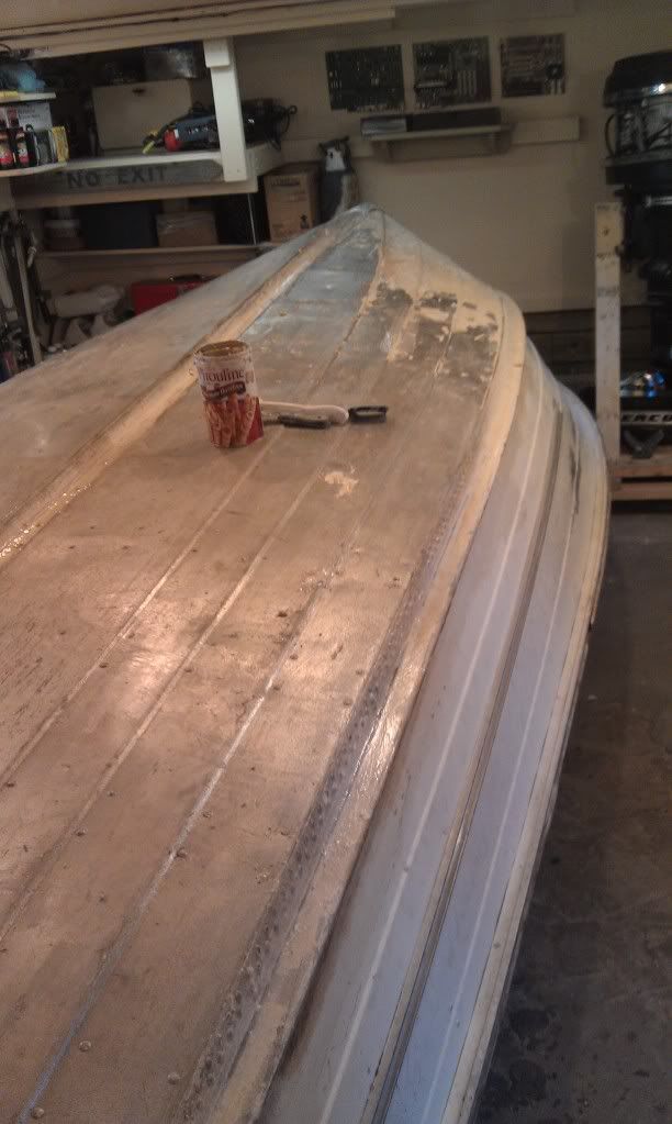

STRIPPING TIME:

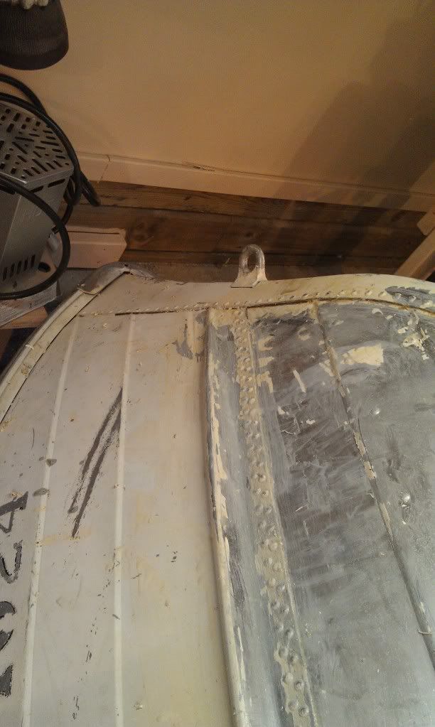

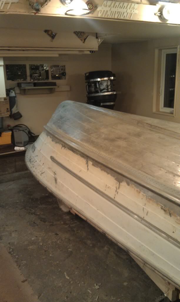

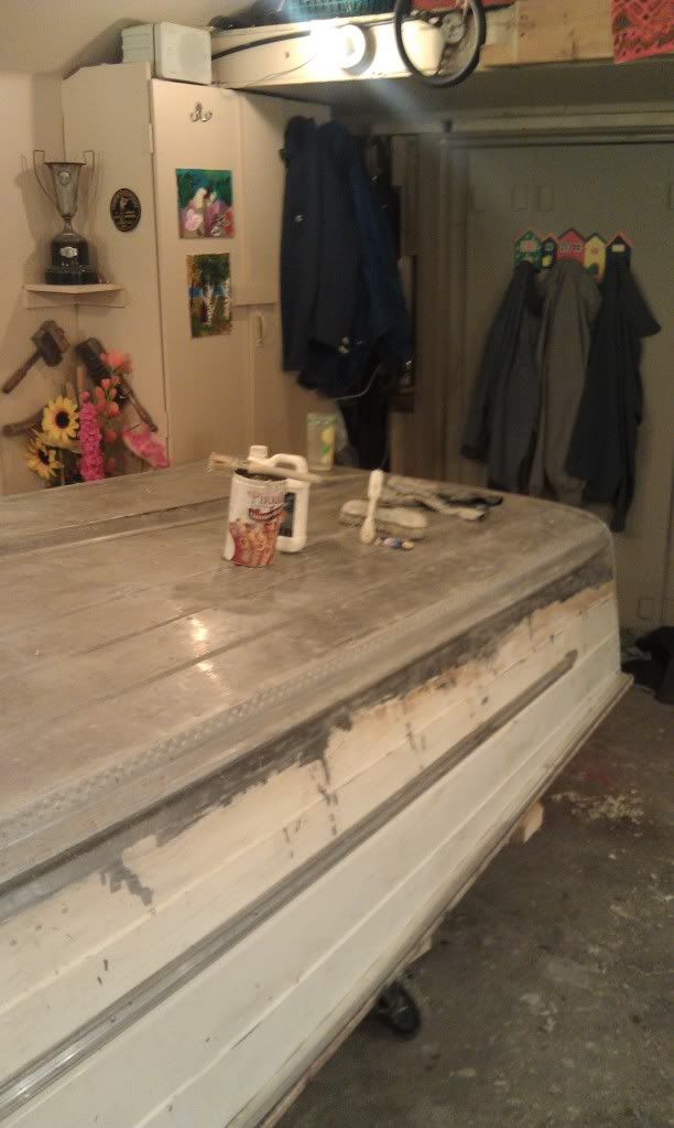

Ok... here's the pic's so far.... 1 side is 90% done and the other about 75% done. Got a little time this morning --- maybe 45 minutes and did the 75% part!
This is the 10% left part at the bow....and under the splash rail (or more acurately on the top of the splash rail if the boat was upright!)
It really needs to be washed down... but most of the paint is gone now.
So the question is how far to strip the paint up the sides so that it ends appropriately at the bow... what's your thoughts fella's?
PS - Who's sending this snow this way -- was 60+F yesterday and now this...
Jim

You can have the snow, we don't want it. How far down the sides do you plan on painting? to the top of the chin strip? If so you could carry that line around the bow on the reinforcment piece above the bow eye.
InMotion
Nov 3, 2011
2,080
Re: 1964 Starcraft Jet - Rebuild
Chewgotitman! Yup... just above the chin strip... although I am going to strip the paint up the first lapstrake from the stern to about half way towards the bow as the paint is really cruddy from the water.

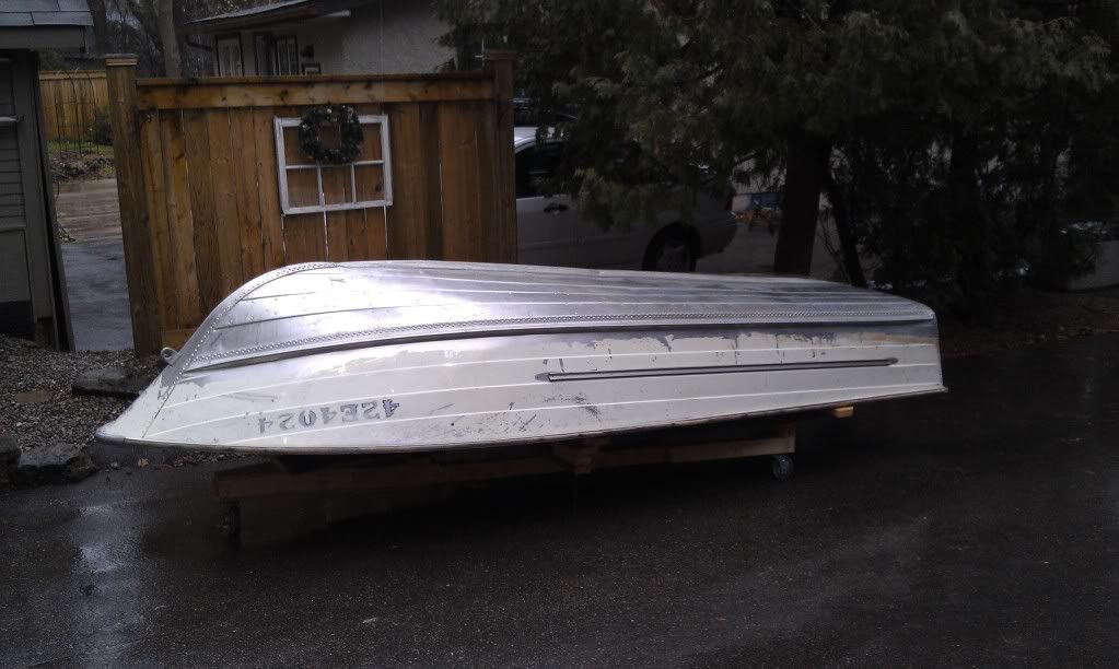

Stripped!
Quick Update here... Ok... all done (with the exception of a 4" x 4" piece just above the bow eye hook... which will get done tomorrow am!).
Just need to get it properly washed/scrubbed up this weekend and polishing can begin.
One other thing I should mention is that it isn't just the time the goop is on the boat, it's the qty of goop(some how using the word "stripper" instead of goop in that sentance didn't quite seam appropriate!). On the sides the goop just runs off rather quickly... on the hull you can really layer it up. Time and qty are the key ingredients.

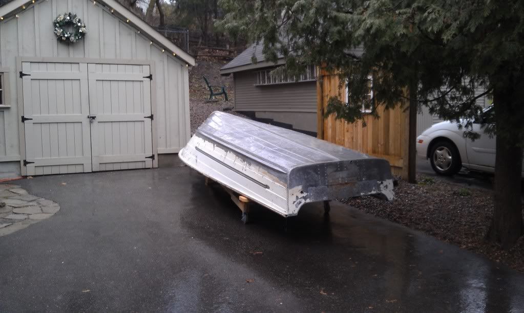

Scrubbed:
Yup... this Canuck braved the near freezing temps, rain, and clouds?!! Fully scrubbed and washed and ready for polishing! It actually went quite well and quickly ---- but it was brisk! I accidentally left some carpet rolled up under the bow of the boat wedged between my boat dolly and the bow it got... well... drenched! So, next step is that everything is drying out and then I will bring the boat back in the mini shop for polishing!
Proof:
There you have it... the messy part is done... oh yah I forgot that the next part is also rather messy too! :)
