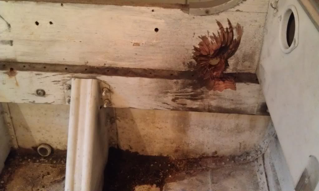

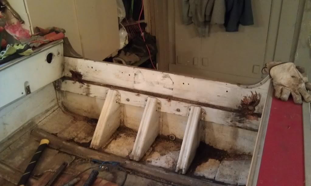

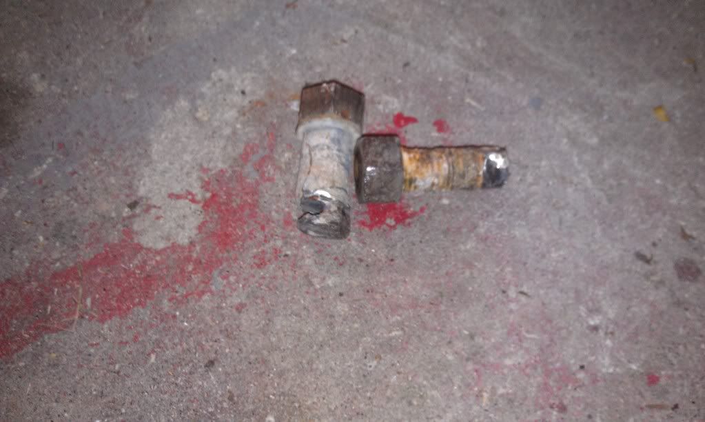

Got the bolts out last night... about half way grinding the stink out of the first one I realized it was futile to try and cut the heads clean off and just simply ground the heads down to the size of the shaft and pounded the bolts from the inside out the back off the boat!
You can see that my first attempt resulted in a fair bit of scoring to the wood...
By the second bolt (left side of the photo) I had more or less got the process down...

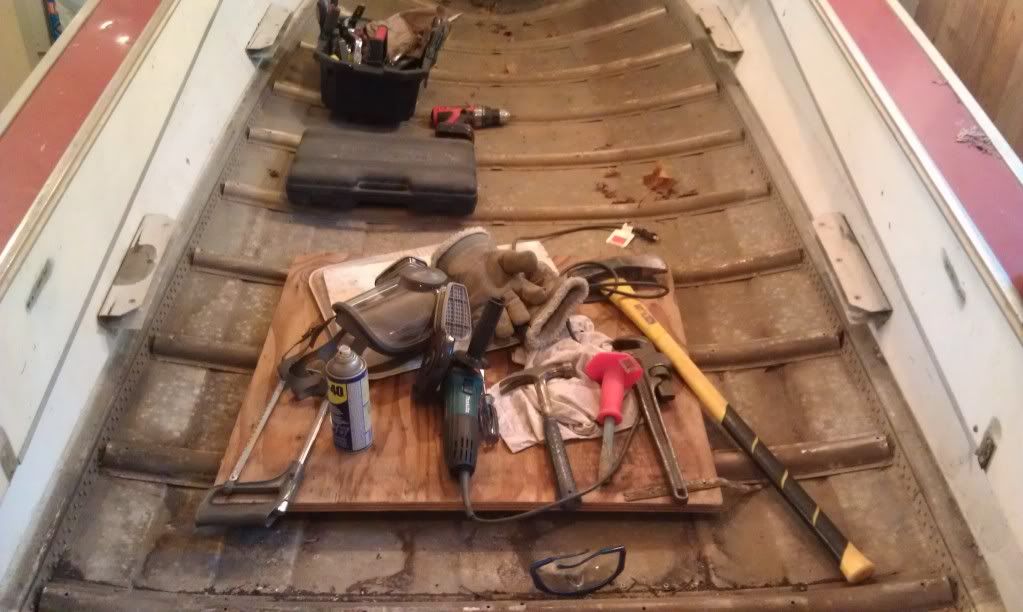

Tools for the job:

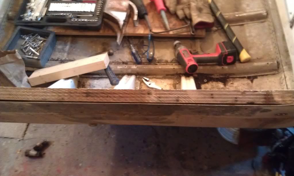

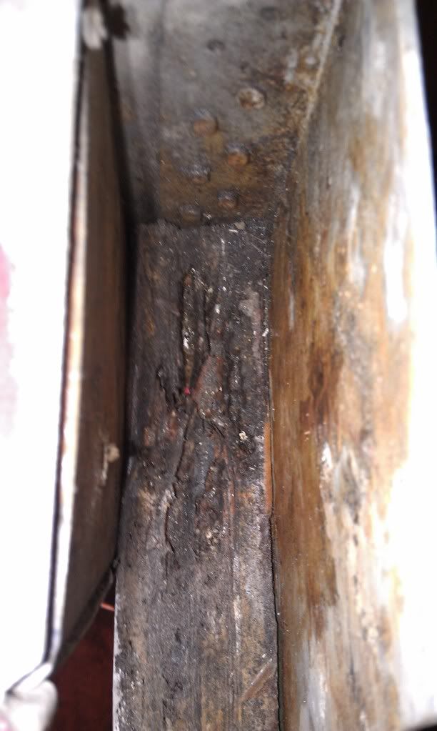

Once I got the big bolts removed from the drain holes, I thought I would snap a photo of the top of the transom board. Both the front and top look great.... but...
Hidden in the corners is a fair bit of rot... which is why it so important for all those who think their transom board is solid and is original to really, really check it out. I have read many threads where folks think it is fine... but if really checked out they more than likely will find that there 35+ year old transom board should be replaced!

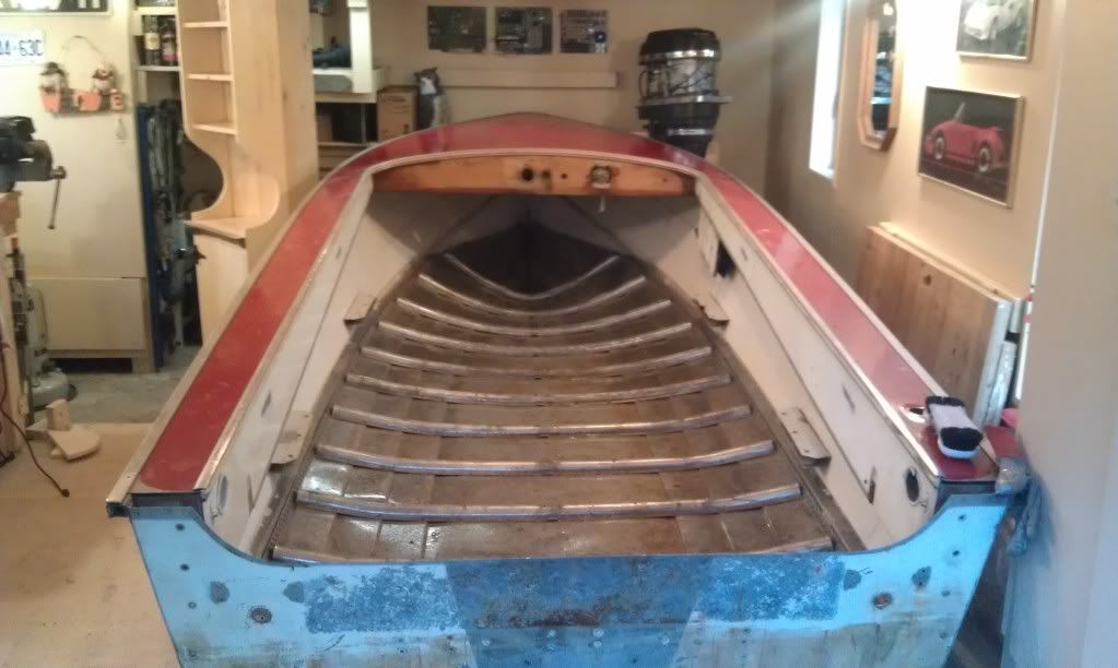

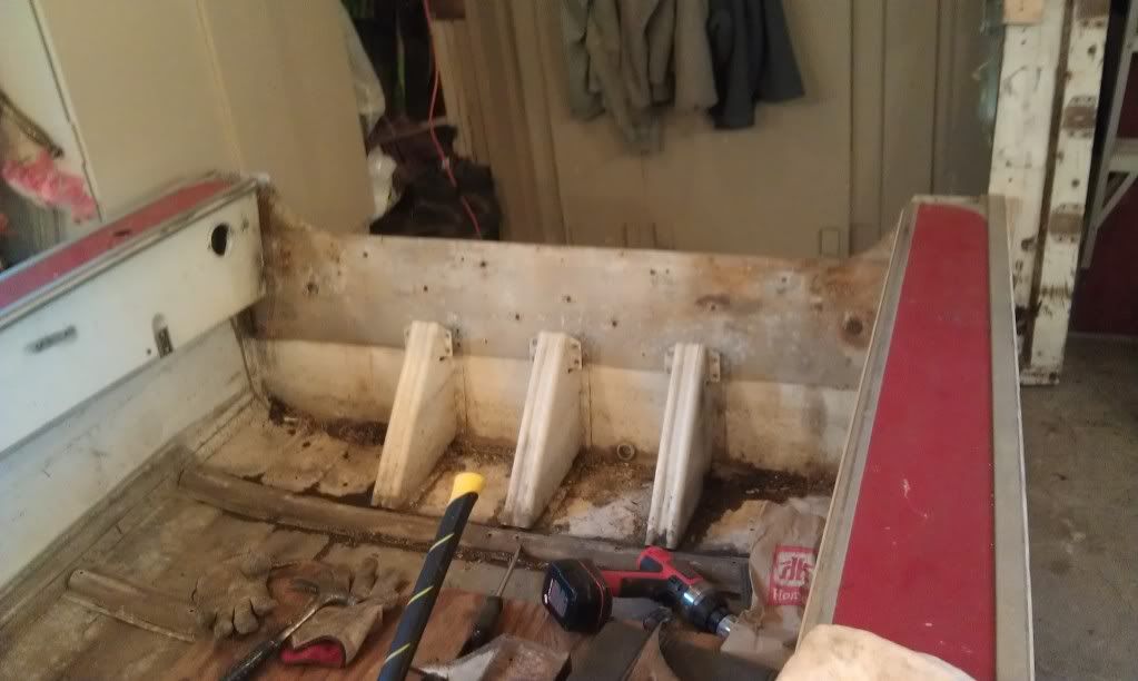

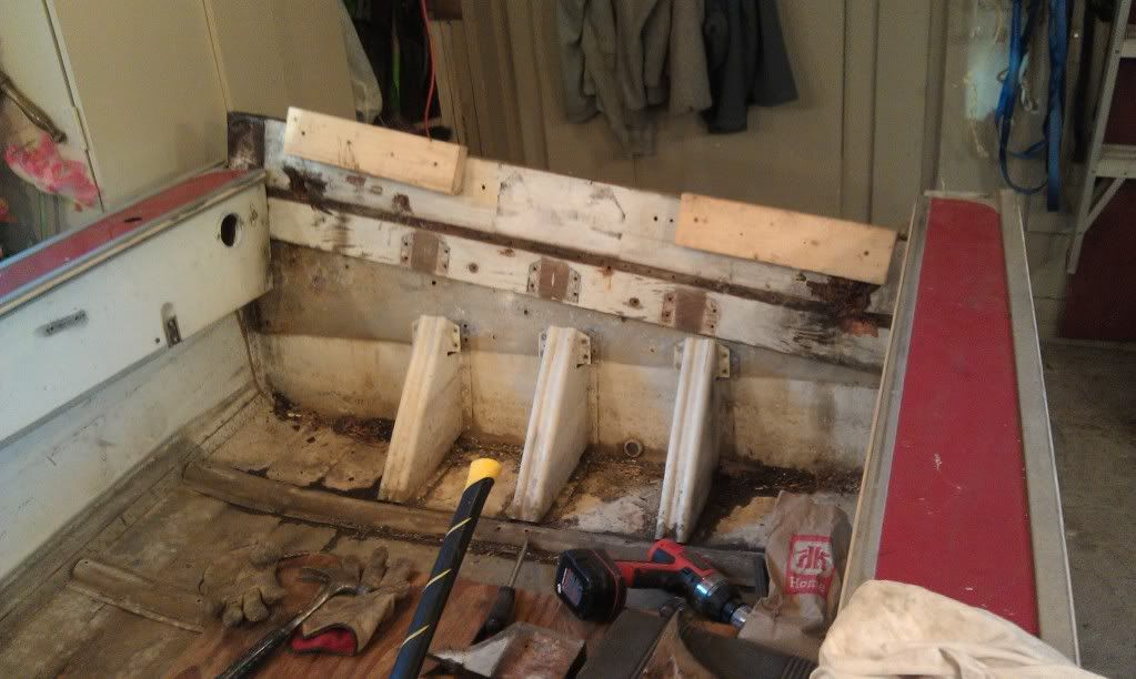

So I removed the 1 million bolts out of the transom --- prolly closer to 20 ---- most came out pretty good actually. Some were a tad more stubborn. I realized that my left had is not that strong yet... so it was a bit of a challenge on the port side of the boat getting the bolts out. But no worries... and here is the transom board out!
It was a bit stuck at the bottom of the gunnels. I hammered in a large flat screwdriver end and pryed it about a bit and the board came out much easier after that. Had to use the sledge as usual.

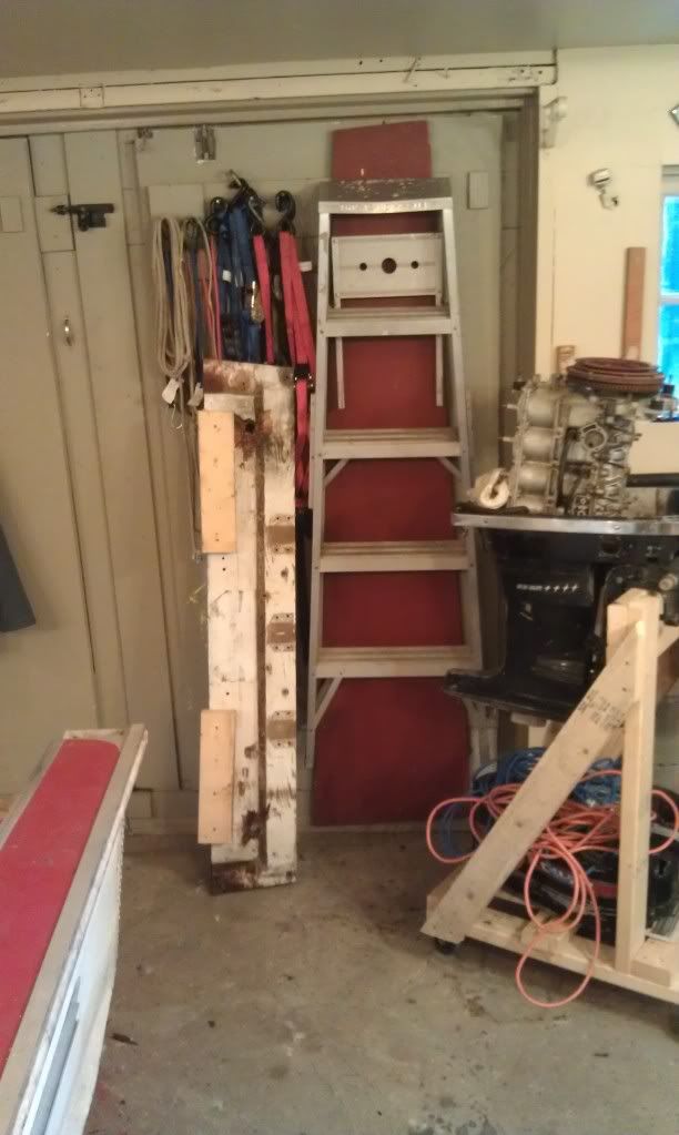

Looking remarkably clean...
Great template beside a almost completely striped down Merc 500.
So there you have it! Boat is ready to be:

A planned attack and you came out victorious! You'll be glad to have that old transom board for a template. It's all in the planning..and then the muscle. Gotta love the Jets, they're built like a brick $%&*house!

Great job Jim, making good progress, makes you really wonder what the PO was thinking when he plugged the splashwell drain with those bolts.???????

Thanks a bunch! Yah still baffled as to why the PO did that... even found out he drilled another 1/4" hole in the bottom of the splashwell to drain the port side if the boat was listing that way! Really funny thing is that there is no bildge hole on the boat! So if there was one, he must of had the hose just flopped over the side or back somewhere!

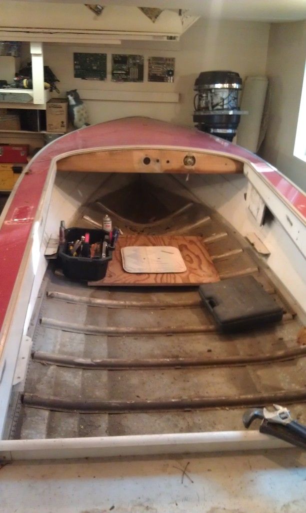

So today it was a tad warmer and things started to melt off a bit and allowed me to scrub the interior of the boat and get it ready to flip this week!
