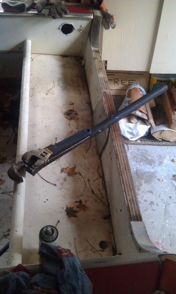

Ok... started on the Jet this morn... immediately ran into a challenge! Check this out... I mentioned it a while back that this was a silly thing to do... actually I get what they PO was trying to do... protect the transom from rot... but really?!!! :)
Notice the 11/2 bolts through the two splashwell drain holes.... not the best idea IMHO!
Inside shot of the bolt...
So I tried using a pipe wrench with an extension and my wrench on the inside head and absolutely no go... would not budge! Tried the liquid wrench.... no go. Gonna leave it for the day and see... otherwise, pending any other suggestion, I was going to cut the head off on the splashwell side so as to not damage the hull.

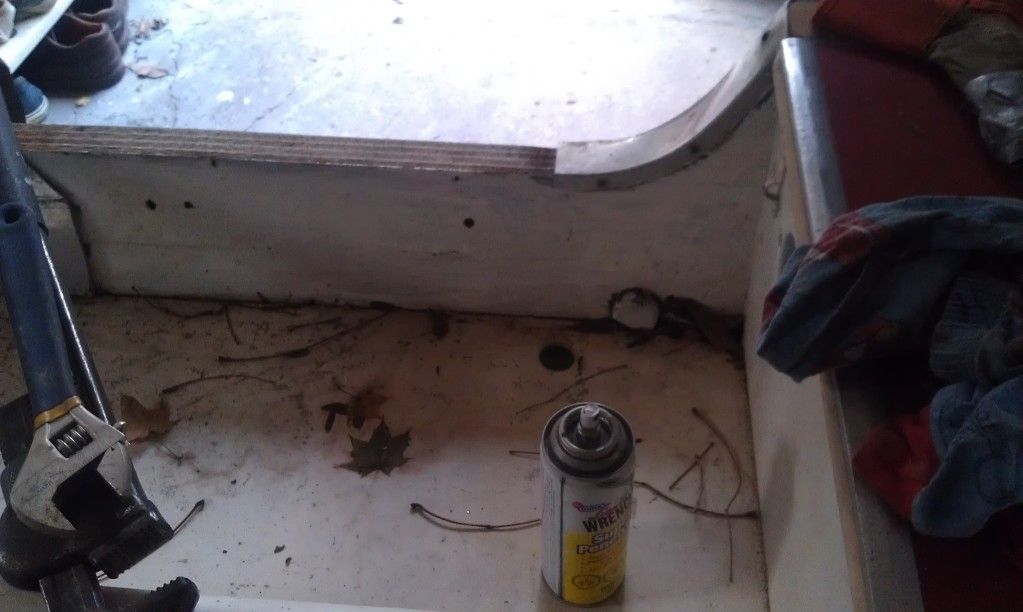

Check this other shot out... again, creative, but not bright... drilled a hole in the bottom of the splashwell to let the splashwell drain INTO the boat... a creative solution to a problem that should never have existed in the first place!

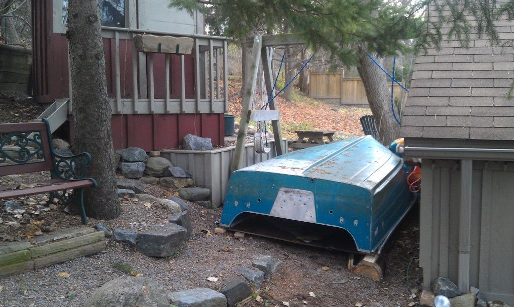

I mentioned that the Falcon has a new winter resting spot... up behind the garage... kids were a little miffed that their swings are of no use... but I countered with the fact that they can now tobboggan down the hill and driveway where the Falcon was sitting! They were happen with that!

Good luck on that bolt Jim. Don't under estimate that liquid wrench... give it a day or two to work and just keep spraying it on there every 8 hours or so. Is there any way to get an impact air wrench in there?

Possibly use some heat?
Or plunge cut thru the bolt & transom w/ a grinder? Cutting on an angle, you're unlikely to risk nicking the exterior skin & wont be near the surface where you might nick the splashwell..
Thanks CJ. Unfortunately, I don't have an impact air wrench... so it's manual mode for me. It is approx. 1 1/2" nut... so a decent size and really rusted. It's been on for a long time.
Gotta take the splash well out anyway... so I figured I would take it out and then attempt grinding the heads off with the wooden transom as the natural backer protecting the alum transom skin.... see how it goes. If I get a chance, Wed or Thurs I will give it a go and see where I get.

Hey Jim, those bolts could be a real bummer to get out, they have had a long time to collect rust in the threads. A little bit of heat with a propane torch will sometimes help the liguid wrench seep into the treads. You have quite a good hill in your back yard!!

PB-Blaster (or Kroil if you can find it) & impact wrench would be my first option. My second option would be grind the head (or nut) off the bolt on the outside & remove the wood transom. The aluminum will flex enough to get past the remaining 1/8" of bolt sticking out. If reusing the wood, use an air hammer to get the rest of the bolt out.
If you don't have the air tools, this would be a great excuse to buy them and you will have them for future projects.

They must have had way too much water coming thru the splashwell drains in rough seas and were too cheap to purchase two scupper valves?
They look that way... been there for a while for sure!
I'm thinking the grinding option if the bolt won't loosen off. I have the grinder and I'm kinda partial to using the tools that I have if at all possible! At some point I will get some air tools... but for now, it's not something on the plate! :) But great ideas!
The PO had must of known more than SC about splashwell drainage design... or he was just not thinking it all the way through. Not as bad as drilling a hole in the hull and then permanently running the bildge... but getting close!

I use heat on stubborn rusted bolts. Liquid Wrench/PB Blaster for a couple of days then heat, brute force and ignorance. If that fails then yea, off with their heads.
Good luck.
