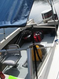

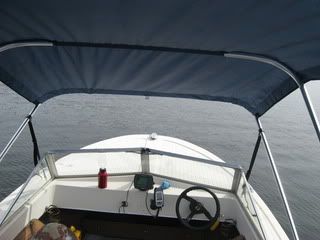

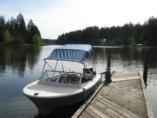

Sea....ah I mean lake trials complete. Man can a new deck and stringers make a difference or what. I finally got everything done that had to be done to get to this point and one extra..the bimini top...and put her on a big lake today. With a mild chop I punched it and went to plane immediatly, which before took a while, and hit 33 on the gps. Handling was better and the solid deck felt great. This level of relief is comparable for a death sentence being taken away, I am so glad that this thing is in the water again and I am never going to sell her!!! A few more things to do but it's all cosmetic. Here are some pics....Will post more after beauty work is done.
At the dock after run with my son who helped drive...all dads out there involve your kids as much as safely possible with your boating and restore you wont regret it!!!
Cockpit view with the top
View of interior...the brown is going to go away, navy blue carpet on the hull and gunwall.
