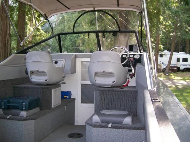

I was thinking of using long pedestals with footrests instead of building boxes for the front seats.
Anyone see any problems with that idea? The deck would be heavily reinforced where the pedestal mounts...
I'm thinking that I might be able to swing that in my rig (barely) but I'd say your cabin would be way too tall. I think you'd be sitting on a telephone pole!
Edit: I just went over to Brett's Starchief, his is a smaller boat but it looks as though he has pedestals. Dunno, maybe you'd be ok???
j_k_bisson
Oct 6, 2010
1,082
Re: 1969 Starcraft Chieftain Restoration
I have to get the paint off before I check for leaks. Its very thick and I would never be able to pinpoint a leak if there was one.
I used paint stripper from home depot to strip mine. It took almost 5 gallons of the stuff to do the job. I counted 6 layers of paint on mine. I used the stripper and a hand held wire bursh to get it off clean. Anything left I used a flat razor blade to chip it off. Actually only took 3-4 days after work.
As to the fuel tanks Where would you put them then? The floor is too shallow for a standard tank. Only custom would fit. On mine the only tanks I could fit where in the boxes. Also The forces from that extra long pedisatal would exert on the floor would a ton when hitting waves and stuff. The other thing. I didn't put any seats in mine.
I normally drive standing up anyways. So didn't need them. For fishing I would just sit on the boxes. The pedisatals would be too tall for comfortable sitting without the boxes. Leggs dangling whn not on the foot rest. JMHO.

Mine came with these (believe it or not) old barstools. They spin 360 but don't move fore/aft so I bought one of these to experiment with: http://www.boatdepot.com/productdetails.aspx?part=20-1011
(I hinged the cabin door so it would pass the passenger seat easily..was a pain originally.:mad:)
Bruce, you're a big guy so this shouldn't be an issue for you but the stock footrest isn't tall enough for me (5'11") when sitting so I use a small foldable foot stool so my feet don't dangle...tackle boxes work too.:rolleyes: When mooring or hauling arse somewhere I prefer to stand so being able to move the seat back should make standing behind the wheel easier/comfortable.
My boys have gunboats for feet so when they're along footroom becomes an issue. The cabin becomes gear storage headquarters on those trips.

That is what Im looking to do right there, except I want to use adjustable height and for and aft adjustment. I really like the round portal window...
