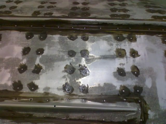

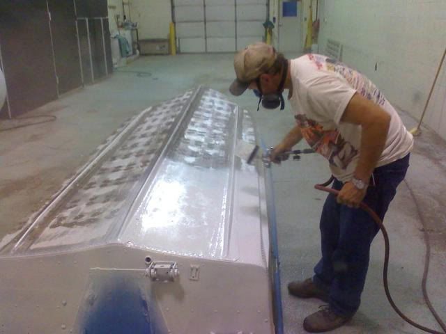

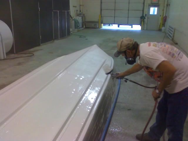

Hey Guys, Here's the rundown for paint. Tonight we're taking the boat into the shop where we'll acid wash it before the primer. We figured we'd do this because it's available and it will allow the primer to stick better. Another advantage to this paint is that it's made for aluminum livestock trailers so it's tough. After the primer is on we're going to put on the white just on the bottom side. We're taking it in multiple steps because this paint is quite thick and it has to properly cure before masking can be done. Getting pretty excited. :D

Well, Today was a really good day. Started at 430am getting the boat primed. It went extremely well. We then put the topcoat on the bottom side and that went even better. After we were done spraying I figured I'd run to Lowe's to get some stuff for the boat and halfway there my truck died. I pulled over and tried to start it and all she did was turn over. I knew right away it was the darn fuel pump. If you've ever owned an 88-98 Chevy truck you probably have ran into this problem. We've had 3 different trucks with 2 fuel pumps a piece...Oh well, like my dad says it could always be alot worse.
After the acid wash
Glu-Vit and Acid wash
My old man spraying the primer
Dad spraying topcoat

That sure is looking great. If I read correctly, you put Gluvit on the outside of the hull as well. Did you sand the gluvit once dried or just prime right over it? How does it look after coating it? I am considering doing the same and have yet to see someone use it in that way. Keep up the great work.
May 27, 2009
65
Re: 1970 Starcraft Mariner Restoration
Yes we put gluvit on the outside too. All we did was rough it up a bit with 220 grit paper then primed it. No sanding after the primer either.

Just curious why you used the Gluvit on the outside of the hull especially since you had access to the inside of the hull. Most of the guys on here that have inside access apply it to all the crevices and seams on the inside. Not sayin it hasn't been done before, just curious.
I'm just sayin...:D
May 27, 2009
65
I'm just sayin...:D
My answer; Why Not? We did it on the inside too by the way.
I am very interested to see your final result. I believe that I am going to do just what you did as well.
Yeah man. Ill take pictures with the good camera tomorrow when we go to the shop. It turned out great and it's basically leak proof.:)

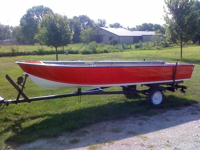

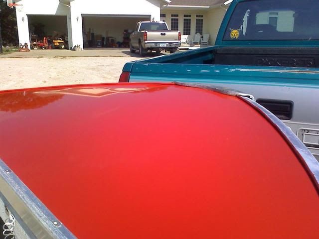

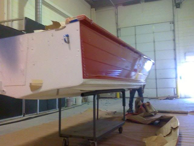

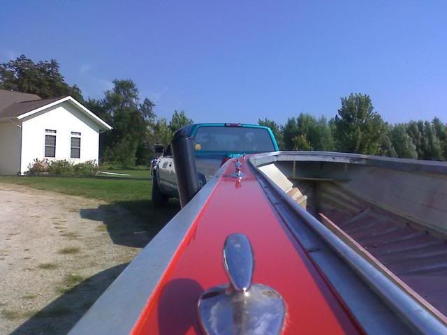

Here's the rest of the pictures. I'm really happy with the results. The chrome stuff looks great with the red.

Real sharp! My wife wishes I'd painted mine red.

Looks Great! Mine is going to be red and white as well. I am going to stick with the original style with the "swoosh" or hockey stick on the side.
