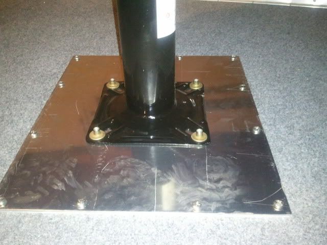

Tiller seat placement. I wanted more strength and stability so I attached the pedestal to a 1 foot square sheet of 1/4 aluminum with countersunk hucks. I then fastened the sheet of aluminum to the deck; using monobolts for the tiller seat and lag screws for the casting deck because that one is made of wood.
