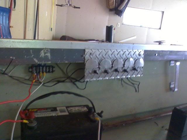

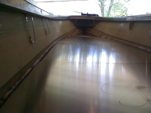

Sorry about being so inactive on here guys. I've been swamped with school and football....but were 2-0 so it's okay. :) Here are some pics of recent work. The floor is just a rough fit, I still have to put foam in and carpet. The electrical is still in progress but I figured that I'd just as well get ahead.

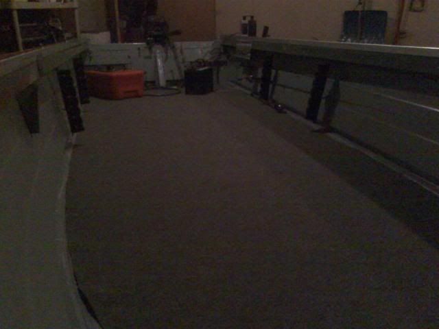

Got the inside painted gray and got the carpet in. All thats left is the seats! :D

Looking great, nice work! Did you lay down a riveted aluminum deck?

Thanks Huron. Yeah we used aluminum monobolts/rivets. The fuel tank is a 6 gallon. I have another tank and I'm thinking about riggin em both up. btw were 7-1. :D

Thanks a lot LastDollar. I used marine grade carpet from Lowes. It was only about 50 bucks for the whole boat. I used some 3-M adhesive, the kind that comes in a pressureized tank and you just spay it on. It worked nicely. Thanks again

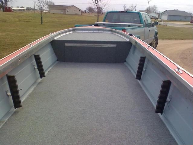

Got around to building a casting deck this weekend. We used 2x4's and 3/4 Plywood. Here's the final product. Until Next Time..
