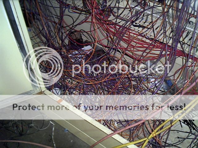

GM, GT and the rest, this is why I am so @n@l retentive about the wiring thing:
This was a nearly 3 month project, every day setting just inside of a cabinet door for 8 hrs a day...
stripping wires, labeling wires, terminating wires:
It was an old 4 door 20'L x 8'H x 30"D telephone cabinet with a PLC window at the bottom of one door and completely empty when I got it. We sand blasted it and repainted the interior and exterior of the cabinet.
I ran 800A of 480Vac 3ph through a fused knife switch and used 400A junction blocks to tap off and distribute the incoming power for 2 460Vac Softstarts, one 45HP and one 65HP, then tapped off of 200A junction blocks to handle individual 3ph fuse blocks for 10 NEMA 1 motor starters each set up on timers which had to time out before passing cascading control voltage on to the next NEMA starter, meaning no matter how fast they turned on the switches on the door at start up, the pump motors would only come on so fast, thus affecting our Peek Power consumption for the week.
My 480 was all in the first two doors of the cabinet and then I had all of my low voltage AC behind Door #3. I had an MCR/ E-Stop relay which Mastered all of the control voltage for the whole Process Line. The MCR controlled 2 Slave MCRs which when energized, controlled all of my 120Vac for Tank Lid Motors and their contactors and all of the ice-cube relays setting up wired Relay Logic for FWD/ Rev direction of a standard single speed, single direction 110Vac motor. It also housed all of my Wet Tank location Start Stop Stations which I ran 24Vac to. It was too far to run 24Vdc to due to voltage drop, but I also had some 24Vdc signal voltage for some Tank Level Switches. All of the 24Vac had to be ran perpendicular to higher voltage wiring to minimize Eddy Current cross chatter on unshielded conductors.
There was over 5 miles of conductors between the 220' Tank Room and the Rectifier Room where the control cabinet was located (which was a wall apart) ranging from 000 to 20ga and I had over 1800 terminations that I made just in this cabinet alone and had only 3 miss-wired. Swapped 2 of the 3 and the 3rd had a break in it as it came from the spool that way; I just didn't catch it. In this same room I also had 200A of 480Vac 3ph I rectified into 3500A of 16Vdc to anodize A/C aluminum.
This was a lot of fun putting together as I used to work on much larger control panels, sub-stations, 300Hz Freq converters (the old fashion type using slip rings) and the newfangled digital Freq converters, and a 72 battery 35KVA 480Vac/208Vac Buss UPS backup system, not to mention a Municipal Swimming Pool Heater used just to heat water which circullated in a "wet" closed loop Fire Suppression system for a 14 acre facility (14 acres of building, not property). We had 7 different brands of PLCs, some domestic, some German and I could program in all of them. One of the 17 Allen Bradly PLCs was used to control HID lighting down in Packing and Shipping only. All of the A/Bs fed back into a centrally located Maintenance office where we could monitor and change programing remotely from that location, all back in the late 80s/ early 90s.
