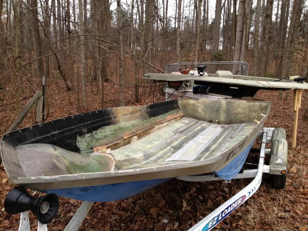

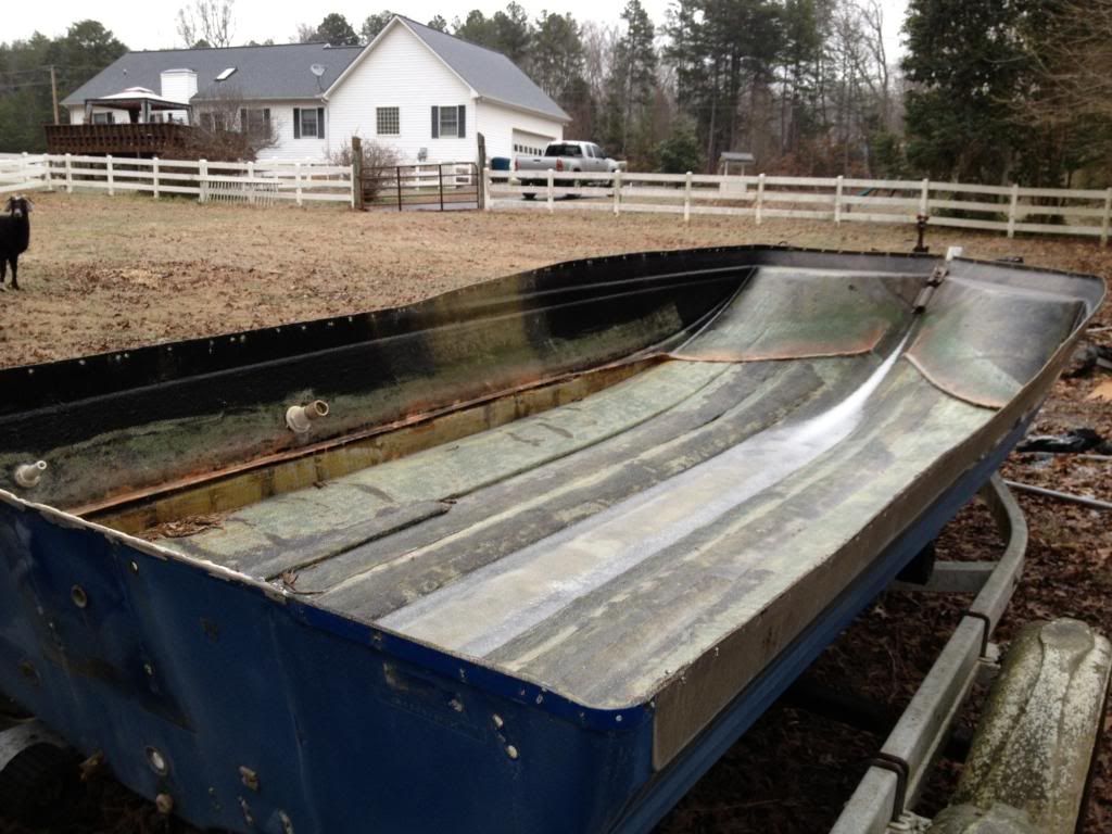

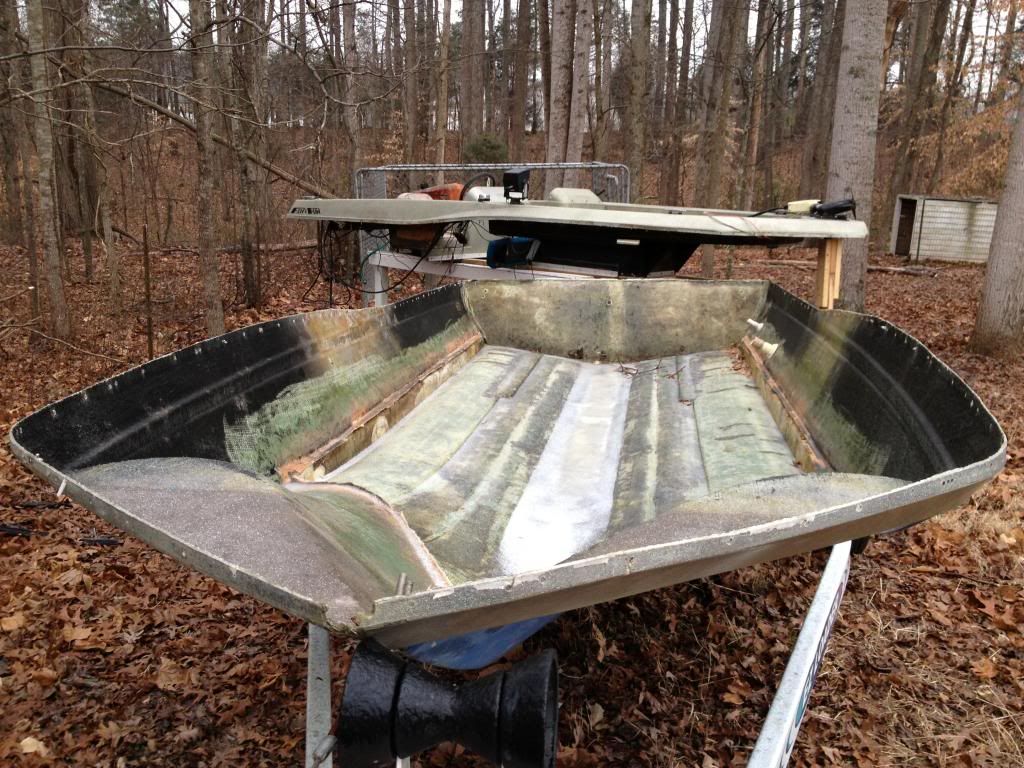

All grinding is done!!!!!! And actually not too itchy!
Now the pressure is on to save up for fiberglass and resin
